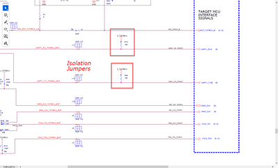

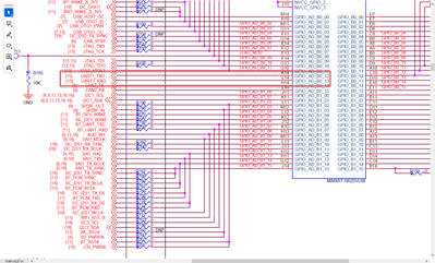

We tested this on the EVK and notice that the pads for ADC1 channel 1 and channel 2 (GPIO_AD_B0_12 and GPIO_AD_B0_13 respectively) are normally used for UART1 that in SDK examples is used to send data to the terminal.
If we check these two pads, they have a pull-up resistor of 10k, this making the ADC1 channel 1 and channel 2 to read high voltage even though the 100k pull-down resistor is enable.
We read the voltage externally and from the ADC and the values is inside the expected taking in to account the voltage divider generated by the 10k and 100k resistors.
This case applies for the EVK only, I'm assuming that you are using a costume board so could you share a part of your schematic? ADC pin channel 1 should be floating, right? Please check if there is no other signal coming to the pin unintentionally.

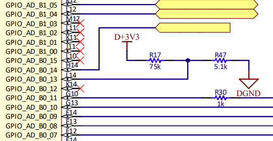

Hi. So here is a snippit of the schematic.
As you can see I have a voltage divider on channel 2 that was supposed to give the voltage level that the ADC would read as HW revision 1. This was working as expected but it turned out however that since GPIO_AD_B0_13  is used as UART1 Rx (as you mention), having a low voltage level on this pin during start up will interfere with the ROM Bootloader Serial Downloader at power on. So I tried to move the HW revision ADC to channel 1 and now I have the issue.

EsbenDN-TC
Yes. The snippit shows the PCB revision where I have the problem. So K14 (channel 1) is floating and I expect to measure 0 (because of internal 100k pull-down). But when I measure I get 1023.

EsbenDN-TC
Just to clear up any potential confusion. The voltage divider resistors R17 and R47 in the schematic snippit are not mounted on the PCB I use for the measurements.

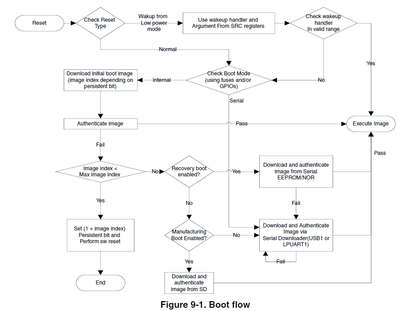

When I run my code, I use internal boot in order to boot from external NOR Flash memory and as the following figure state this boot mode don't use the ROM Bootloader pins as LPUART1
See figure 9-1 of i.MX RT1060 Processor Reference Manual
When you run your application is there any difference in our boot mode and boot device?
