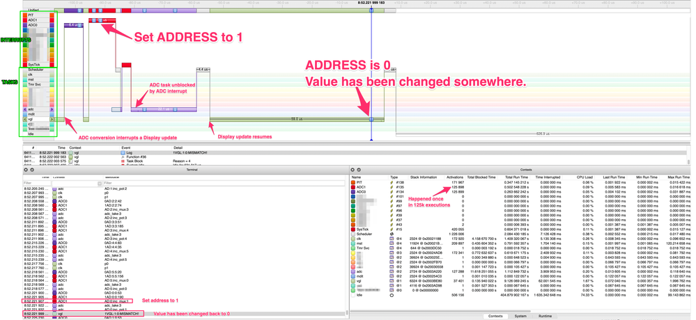

I'm not sure if this is helpful, but I have captured the error condition on a debug trace in SystemView and annotated it:

Thanks, I had already tried a critical section, and the behaviour was the same.
I think I have narrowed it down somewhat.
The GPIO mux address lines are wrong/reset when the ADC interrupt is fired and preempts another FreeRTOS task that is updating a display.
The display task is using the fsl_flexio_mculcd driver which is configured for FlexIO parallel output.  The display CS, RS and FlexIO use the same GPIO base (GPIO1) as the mux address lines, although the individual pins don't overlap.
It seems that either the CS, RS or FlexIO setting in the display update routines must occasionally reset the mux address lines when the task switches context from the ADC interrupt.
I'm not sure where to go from there, as the fsl_flexio_mculcd driver is library code from NXP.
