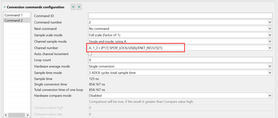

Hi:NXP TechSupport,Another problem I have is that I am using the LPADC module,I used the ADC1 [N13] GPIO_AD_06 CHANNEL0 and [P17] GPIO_AD_12 CHANNEL3 of the LPADC module, and I found that the ADC value of CHANNEL0 is correct, and the ADC value of CHANNEL3 is always 4095. But I'm using SDK_2_12_1_MIMXRT1170-EVK.zip SDK, so I think there may be something wrong with my configuration. Could you please help me check it
Here is my configuration
const lpadc_config_t LPADC1_config = {
.enableInDozeMode = true,
.enableAnalogPreliminary = false,
.powerUpDelay = 0x80UL,
.referenceVoltageSource = kLPADC_ReferenceVoltageAlt2,
.powerLevelMode = kLPADC_PowerLevelAlt1,
.triggerPriorityPolicy = kLPADC_TriggerPriorityPreemptImmediately,
.enableConvPause = false,
.convPauseDelay = 0UL,
.FIFOWatermark = 0UL,
lpadc_conv_command_config_t LPADC1_commandsConfig[2] = {
.sampleScaleMode = kLPADC_SampleFullScale,
.sampleChannelMode = kLPADC_SampleChannelSingleEndSideA,
.channelNumber = 0U,
.chainedNextCommandNumber = 2,
.enableAutoChannelIncrement = false,
.loopCount = 0UL,
.hardwareAverageMode = kLPADC_HardwareAverageCount1,
.sampleTimeMode = kLPADC_SampleTimeADCK3,
.hardwareCompareMode = kLPADC_HardwareCompareDisabled,
.hardwareCompareValueHigh = 0UL,
.hardwareCompareValueLow = 0UL,
.channelNumber = 3U,
.chainedNextCommandNumber = 0,
.loopCount = 0UL,
lpadc_conv_trigger_config_t LPADC1_triggersConfig[2] = {
.targetCommandId = 1,
.delayPower = 0UL,
.priority = 1,
.enableHardwareTrigger = true
.targetCommandId = 2,
.delayPower = 0UL,
.priority = 1,
.enableHardwareTrigger = false
static void LPADC1_init(void) {
/* Initialize LPADC converter */
LPADC_Init(LPADC1_PERIPHERAL, &LPADC1_config);
/* Configure conversion command 1. */
LPADC_SetConvCommandConfig(LPADC1_PERIPHERAL, 1, &LPADC1_commandsConfig[0]);
/* Configure conversion command 2. */
LPADC_SetConvCommandConfig(LPADC1_PERIPHERAL, 2, &LPADC1_commandsConfig[1]);
/* Configure trigger 0. */
LPADC_SetConvTriggerConfig(LPADC1_PERIPHERAL, 0, &LPADC1_triggersConfig[0]);
/* Configure trigger 1. */
LPADC_SetConvTriggerConfig(LPADC1_PERIPHERAL, 1, &LPADC1_triggersConfig[1]);
/* Interrupt vector ADC1_IRQn priority settings in the NVIC. */
NVIC_SetPriority(LPADC1_IRQN, LPADC1_IRQ_PRIORITY);
/* Enable interrupts from LPADC */
LPADC_EnableInterrupts(LPADC1_PERIPHERAL, (kLPADC_FIFOWatermarkInterruptEnable));
/* Enable interrupt ADC1_IRQn request in the NVIC. */
EnableIRQ(LPADC1_IRQN);
void DEMO_LPADC_IRQ_HANDLER_FUNC(void)
#if 0
ADC_ETC_ClearInterruptStatusFlags(DEMO_ADC_ETC_BASE, kADC_ETC_Trg0TriggerSource, kADC_ETC_Done0StatusFlagMask);
g_AdcConversionDoneFlag = true;
/* Get result from the trigger source chain 0. */
g_AdcConversionValue[0] = ADC_ETC_GetADCConversionValue(DEMO_ADC_ETC_BASE, DEMO_ADC_ETC_TRIGGER_GROUP, 0U);
g_AdcConversionValue[1] = ADC_ETC_GetADCConversionValue(DEMO_ADC_ETC_BASE, DEMO_ADC_ETC_TRIGGER_GROUP, 3U);
__DSB();
#else
g_LpadcInterruptCounter++;
#if (defined(FSL_FEATURE_LPADC_FIFO_COUNT) && (FSL_FEATURE_LPADC_FIFO_COUNT == 2U))
if (LPADC_GetConvResult(DEMO_LPADC_BASE, &g_LpadcResultConfigStruct, 0U))
#else
if (LPADC_GetConvResult(DEMO_LPADC_BASE, &g_LpadcResultConfigStruct))
#endif /* FSL_FEATURE_LPADC_FIFO_COUNT */
g_LpadcConversionCompletedFlag = true;
SDK_ISR_EXIT_BARRIER;
#endif
int main(void)
uint32_t pwmVal = 4;
/* Board pin, clock, debug console init */
BOARD_ConfigMPU();
BOARD_InitPins();
BOARD_BootClockRUN();
BOARD_InitBootPeripherals();
BOARD_InitDebugConsole();
/* Print a note to terminal. */
while (1)
SDK_DelayAtLeastUs(100000, SDK_DEVICE_MAXIMUM_CPU_CLOCK_FREQUENCY);
LPADC_DoSoftwareTrigger(DEMO_LPADC_BASE, 1U); /* 1U is trigger0 mask. */

Hui_Ma
Please double check if you select the correct product for MCUXpresso Configuration tool.
Correct P17 pin should with below info:
28,576 Views

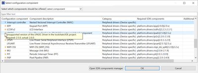

ywjack
Yes, I think there is a problem here, I use SDK_2_12_1_MIMXRT1170-EVK.zip SDK library, it is strange that you can not add LPADC module in peripheral components, so I found a.mex configuration file in RT forum, I will provide you to see. So I wonder if SDK_2_12_1_MIMXRT1170-EVK.zip doesn't support LPADC configuration, or if I misunderstood.
Here's a pop-up warning when I configure it

Hui_Ma
What's the MCUXpresso IDE version you are using?
The latest version is V11.6.1, related release note with below info:
28,563 Views
ywjack
I USE
MCUXpressoIDE_11.6.1_8255.exe
MCUXpresso_Config_Tools_v12.1_x64.exe
28,561 Views
.delayPower = 0UL,
.priority = 1,
.delayPower = 0UL,
.priority = 1,
