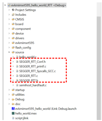

  1. Copy Required Files
    Copy the following files to the
    source folder of the hello_world project:
    • SEGGER_RTT_Syscalls_GCC.c
    • SEGGER_RTT_Conf.h
    • SEGGER_RTT_printf.c
    • SEGGER_RTT.c
    • SEGGER_RTT.h
  • Copy these source files to the source folder of the hello_world project:

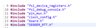

  1. Integrate into Project
    If using Keil or IAR, you may need to add header file dependencies. However, since the RTT files are placed directly in the MCUXpresso project’s
    source folder, you only need to call the relevant RTT functions in hello_world.c.

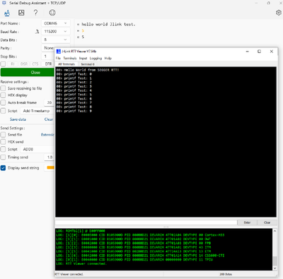

  1. Use JLink RTT Viewer
    Launch the JLink RTT Viewer program, select the appropriate device number, run the program, and open "Terminal 0" to view the output.
