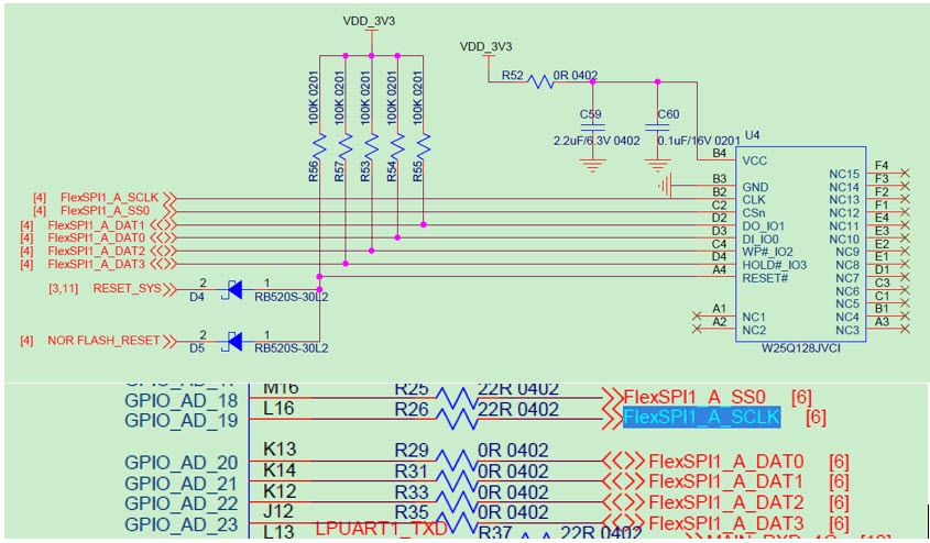

Here, I would like to thank the customer who are providing the test platform, because the official MIMXRT1170-EVK is an external QSPI flash connected from the FlexSPI1 primary interface and does not provide a secondary group interface.
2 Related prepare
To test the FlexSPI1 Secondary pin group, you must first prepare a board that connects the QSPI flash to the Secondary pin, and then configure the FlexSPI_PIN_GROUP_SEL fuse to 1. Since the FlexSPI1 secondary pin group is already connected to the GPIO_AD port, the maximum speed limit is 104Mhz.

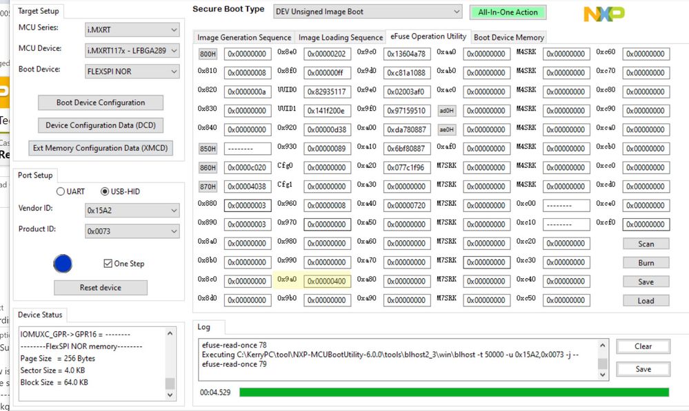

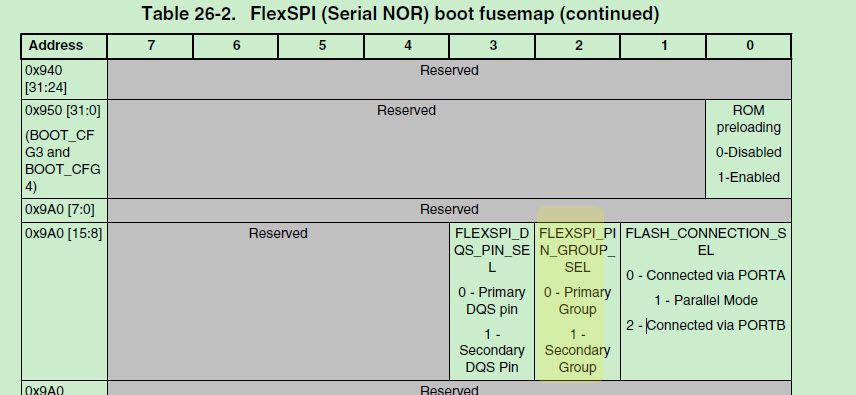

2.2 fuse FLEXSPI_PIN_GROUP_SEL burn
  FLEXSPI_PIN_GROUP_SEL fuse address is 0X9A0[10]:
Fig 3

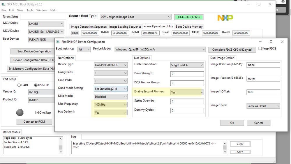

To burn fuse, let the chip to enter serial download mode and connect through MCUBootutility. When connecting, you need to select the FlexSPI1 secondary option, as follows:
Fig 4
Burn fuse result is:
Fig 5
After the fuse is burned successfully, change the board boot mode to internal boot mode, then we can program the app and boot from the flash which is connecting to the FlexSPI1 secondary pin group.

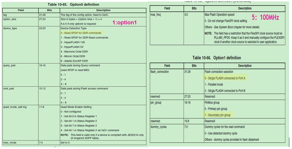

3 Flash algorithm modification and debug test
Regarding the flash algorithm of RT1170 FlexSPI1 for secondary pin group, this article mainly focuses on the preparation and testing of MCUxpresso IDE, two debuggers: CMSIS DAP's .cfx, and JLINK's RT-UFL flash algorithm.
Here is a brief explanation of the principle of modifying the flash algorithm. It is actually based on the ROM API. Therefore, the main modification point is :
option0 =0xc1000005, option1=0x00010000.
Fig 6

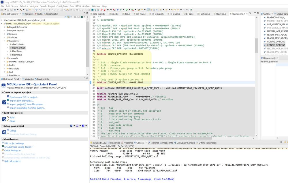

After importing the algorithm source code, first compile the LPCXFlashDriverLib<Release_SectorHashing> version to get the lib that needs to be called. For iMXRTt117x_FlexSPI_SFDP, select the MIMXRT1170_SFDP_QSPI (FlexSPI1 Port A QSPI) version, and modify Imxrt117xFlexSPI_SFDP, FlashConfig.h:
#define CONFIG_OPTION0 0xc1 000005
#define CONFIG_OPTION1 0x00010000
    Then compile the lib and compile Imxrt117xFlexSPI_SFDP to generate .cfx,

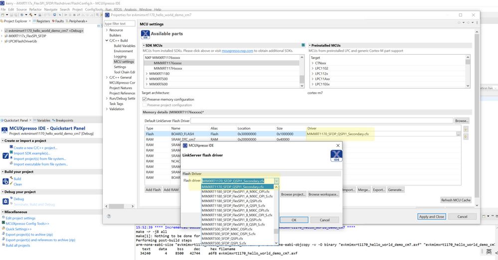

   After preparing the APP and CMSIS DAP debugger, select compiled .cfx flash algorithm in the app project:
Fig 8

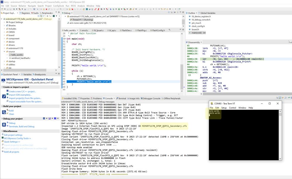

Debug result is:
Fig 9
It can be seen that the modified flexSPI1 secondary group flash algorithm has been successfully called, the downloading is successful, and the app function runs normally.

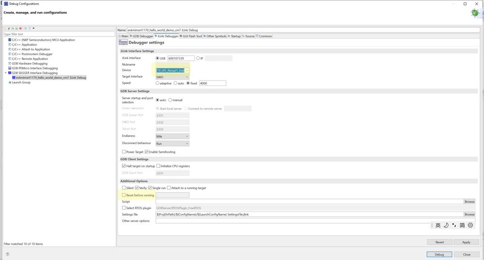

In the app project, debug configuration,configure the JLINK device as:
MIMXRT1170_UFL_flexspi1_2nd
  Note: uncheck “reset before running”, otherwise, it will be stopped in ROM after entering the debug mode.
