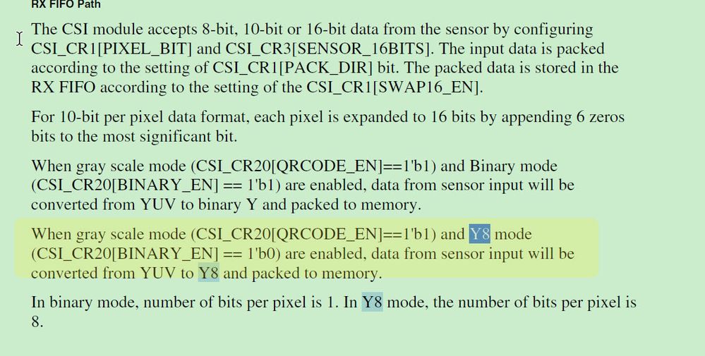

From the reference manual of RT1170, you can see the following information:
Fig 1
This description can be understood as requiring the Y8 mode, as long as the configuration:
CSI_CR20[BINARY_EN]=0
CSI_CR20[BIG_END]=1
However, in reality, with this configuration, the original YUV code cannot display the camera data. So how should the camera's Y8 configuration be done to display black and white images on the LCD? This article will give a detailed explanation.

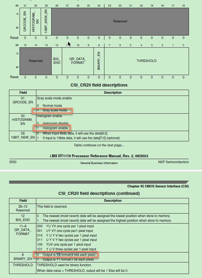

2.2 Y8 formation configuration
  In fact, for CSI_CR20 configuration, you also need to enable the Histogram function, which is the following register bits:
Fig 2
Here, based on the current SDK demo evkmimxrt1170_csi_mipi_yuv_cm7 demo, modify it to the Y8 format, list the modification points, mainly modify the file:csi_mipi_yuv.c
(1) static void DEMO_InitPxp(void)
Modify:
   PXP_SetCsc1Mode(DEMO_PXP, kPXP_Csc1YCbCr2RGB);
To:
    PXP_SetCsc1Mode(DEMO_PXP, kPXP_Csc1YUV2RGB);
If this item is not modified, LCD will just display the Green color.
(2)static void DEMO_InitCamera(void)
Before BOARD_InitMipiCsi(); Add the this code:
CSI->CR20 |= CSI_CR20_QRCODE_EN_MASK | CSI_CR20_HISTOGRAM_EN_MASK;
Here, didn’t configure CSI_CR20[BINARY_EN]=0, as after reseting, this bit is default to 0. If in the practical usage, this bit is modified to 1, then here, need to modify BINARY_EN to 0, it means the format is Y8, not Y1.
The reason that can’t display the correct Y8 previously, is caused by the bit HISTOGRAM_EN is not set.

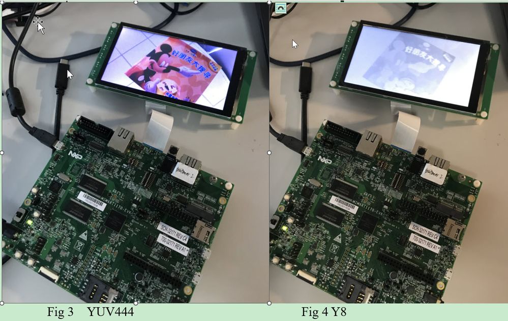

2.3 Test result after modification
Below we use the same color picture to test the YUV and Y8 display effects in front of the camera. here are the pictures:
the camera format of the picture on the left is YUV444, and the picture on the right is in Y8 format. You can see that the left one is in color, and the right one is in black and white. The black and white Y8 camera data acquisition and LCD display have been successfully completed.
