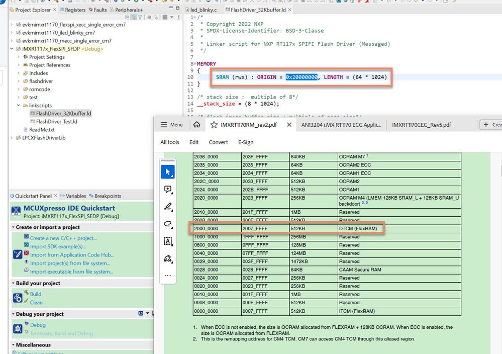

1.    Abstract
This article aims to solve the problem that after enabling the ECC function, RT1170 cannot be debugged using CMSIS DAP in the three major IDEs (MCUXpresso, IAR, MDK). ECC is enabled by burning the relevant fuses and enabling ROM preloading, which means that the ROM will help initialize the RAM. However, in actual use, it is found that different debuggers have different appearances on the IDE. For example, Segger JLINK can directly implement debugging, but when CMSIS DAP is combined with the three major IDEs, there will be a problem that the code cannot be debugged after being downloaded to RAM. Here, taking MCUXpresso IDE as an example, after burning the ECC-related fuses on the MIMXRT1170-EVK board, if the project is burned to RAM, it can be debugged directly. However, if the project is burned to flash, there will be problems with flashloader:
Fig 1
   So is this problem caused by the mismatch of flashloader, or does it require additional operations? This article will give a specific solution!

2.3 ECC debug issue solution methods
After testing in many ways, such as initializing RAM in the script, because of the characteristics of ECC, RAM needs to be flashed once, but it is found that the general code speed of flashing RAM directly is too slow, resulting in download timeout problems, and then it is changed to use DMA to move data to RAM to ensure that RAM is flashed once, but the result is still not good, so flashing RAM is not the fundamental way to solve the debug problem. Finally, by chance, ECC is turned off in the connection script first, especially FlexRAM ECC, and it is found that the burning algorithm can be called to perform external flash operations at this time. In this way, the code can be successfully downloaded, and then reset to let the ROM turn on the ECC function by itself.
The reason why the RAM project can work is that the process of downloading RAM is a process of flashing RAM, so the RAM code can work directly.
For the debugger burning and simulation of Flash code, it is still necessary to turn off the ECC module first, mainly the FlexRAM ECC module. Of course, for the sake of insurance, we can directly turn off all MECC and FlexRAM ECC register enable bits, let the flashloader work first, and directly control the register address:

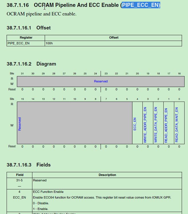

0x40014100=00x40018100=00x40028108=0
  • 0x40014100 PIPE_ECC_EN[ECC_EN], control MECC1
  • 0x40018100 PIPE_ECC_EN[ECC_EN], control MECC2
Fig 3
  • 0x40028108 FLEXRAM_CTRL ECC_EN, control FlexRAM ECC
Fig 4
According to the actual test situation, disabling FlexRAM ECC is effective. The problem should be that the area where the flashloader used is stored is the DTCM of FlexRAM. Check the area of ​​the Flashloader of the burning algorithm as follows:
Fig 5

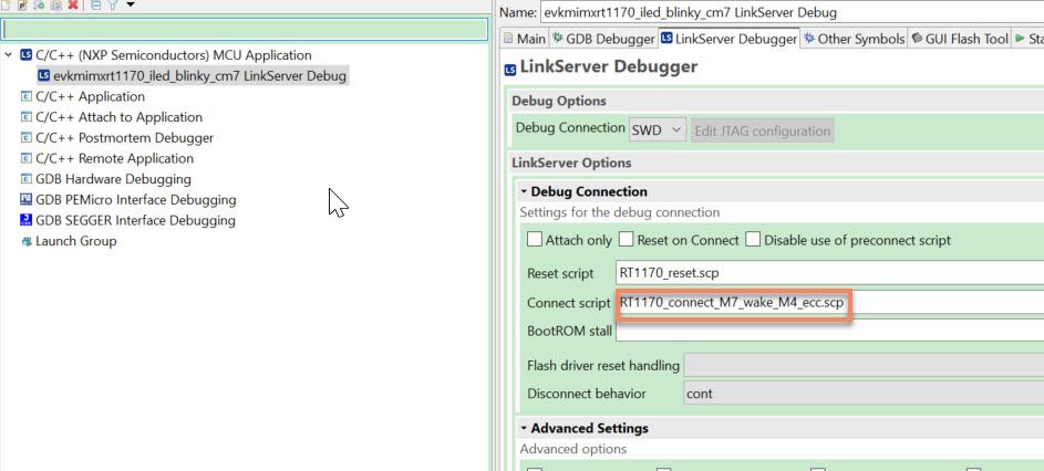

3.1 MCUXpresso IDE
Script path in the IDE:
C:\nxp\MCUXpressoIDE_11.9.0_2144\ide\LinkServer\binaries\Scripts
Prepare one script file T1170_connect_M7_wake_M4_ecc.scp,copy it to the above path, and the content is:

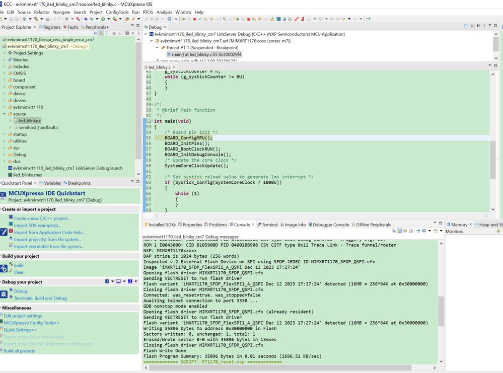

 MCUXpresso debug configuration,in the “connect script” item, select the above prepared .scp file:
Fig 6
The result after Debug is:
Fig 7
We can see, the code downloading and debugging all works now.

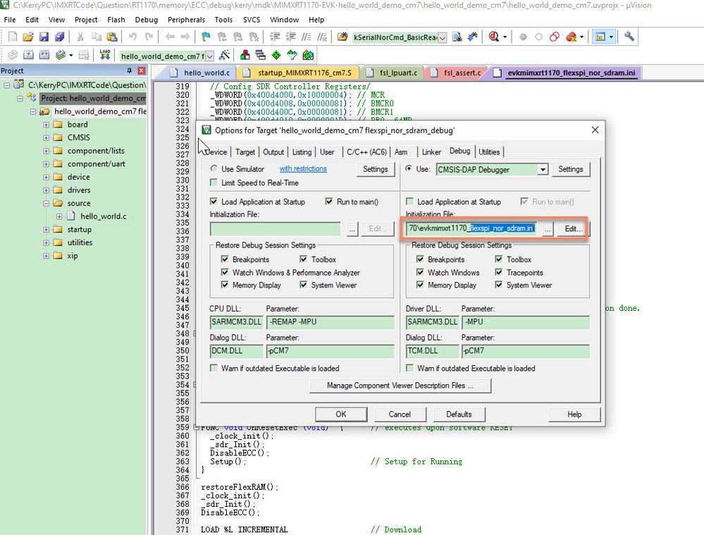

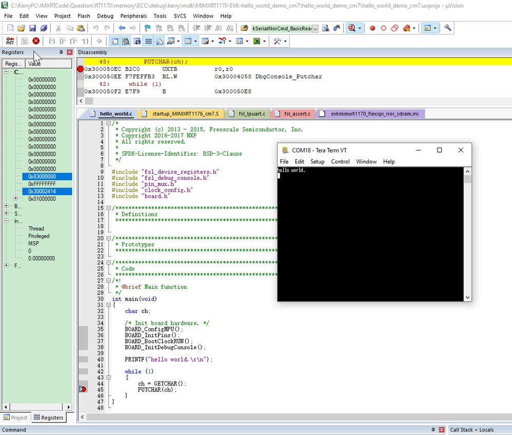

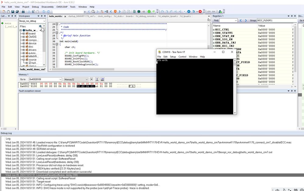

3.2 IAR IDE ECC script and testing
IAR project script path:
\MIMXRT1170-EVK-hello_world_demo_cm7\hello_world_demo_cm7\evkmimxrt1170
Prepare the file: evkmimxrt1170_connect_cm7_disableECC.mac
The content is:

Mainly add the above red code, which is used to clear the MECC and FlexRAM ECC enable bit.
Add the modified mac script:
Fig 8
Debug result is:
Fig 9
We can see, in the IAR also can do the code downloading and debugging, the script also works for the ECC enabled board.
3.3 MDK IDE ECC script and test result
  Open the project path:
Prepare the file:evkmimxrt1170_flexspi_nor_sdram.ini, the content is:
 * Copyright 2019-2021 NXP
 * All rights reserved.
 * SPDX-License-Identifier: BSD-3-Clause

FUNC void Setup (void) {
  SP = _RDWORD(0x30002000);          // Setup Stack Pointer
  PC = _RDWORD(0x30002004);          // Setup Program Counter
  _WDWORD(0xE000ED08, 0x30002000);   // Setup Vector Table Offset Register
FUNC void DisableECC(){
  _WDWORD(0x40014100, 0x00000000);
	_WDWORD(0x40018100, 0x00000000);
	_WDWORD(0x40028108, 0x00000000);
FUNC void OnResetExec (void)  {      // executes upon software RESET
  _clock_init();
  _sdr_Init();
	DisableECC();
  Setup();                           // Setup for Running
restoreFlexRAM();
_clock_init();
_sdr_Init();
DisableECC();
LOAD %L INCREMENTAL                  // Download
// g, main
 In the project, add the prepared script file:
Fig 10
Debug result is:
Fig 11
We can see, in MDK, debugging can also be successful using CMSIS DAP.
