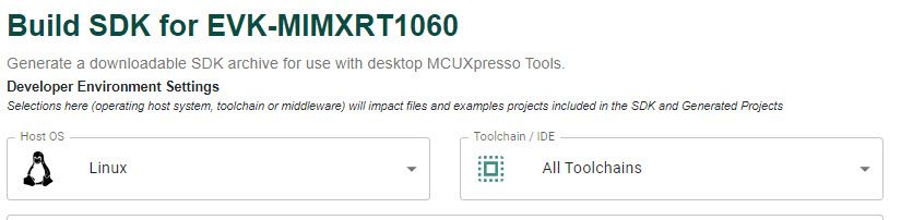

2.1 SDK downloading
    Download link: https://mcuxpresso.nxp.com/en/builder?hw=EVK-MIMXRT1060
Fig 1
Download the SDK code, named as: SDK_2_13_1_EVK-MIMXRT1060_linux.zip

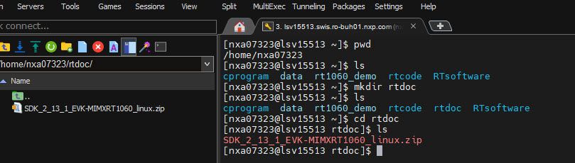

If you download it under Windows, you need to copy the SDK to the Ubuntu system. Here you can use FileZilla or MobaXterm to transfer the file. Because I use the web server Ubuntu, it is based on MobaXterm. This software is free to use, and the download link is:
https://mobaxterm.mobatek.net/
Put the downloaded SDK into the Ubuntu folder, in MobaXterm, drag the file can realize the file transfer from Windows to Ubuntu:
Fig 2

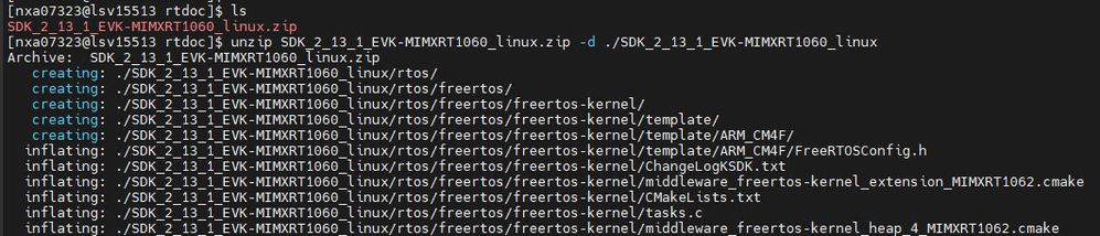

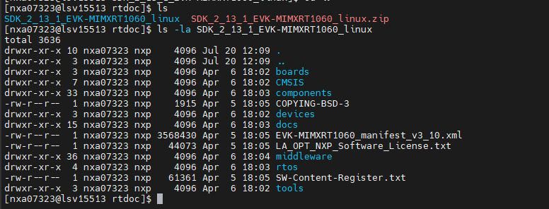

Unzip SDK, the commander is:
unzip SDK_2_13_1_EVK-MIMXRT1060_linux.zip -d ./SDK_2_13_1_EVK-MIMXRT1060_linux
Fig 3
Fig 4
It can be seen that the SDK has been successfully unzipped to the SDK_2_13_1_EVK-MIMXRT1060_linux folder.
At this point, the Linux SDK is ready to use.

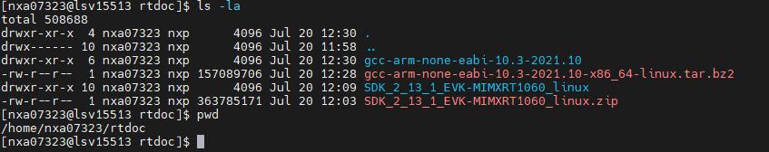

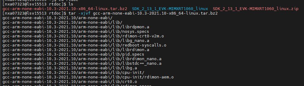

Copy it to the Ubuntu, and unzip it, the unzip commander is:
tar -xjvf gcc-arm-none-eabi-10.3-2021.10-x86_64-linux.tar.bz2
Fig 5
Fig 6
You can see that ARMGCC has been decompressed.

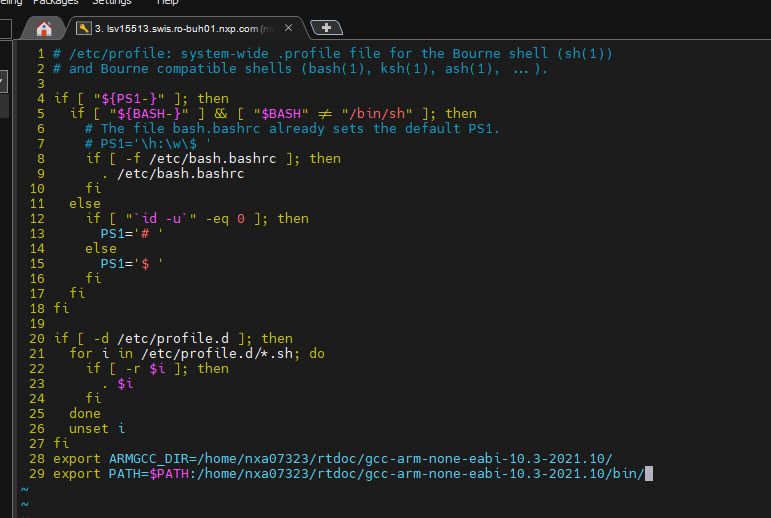

Configure the environment variables below and add ARMGCC_DIR to /etc/profile:
Add the path at the end of the profile to save and exit:
export ARMGCC_DIR=/home/nxa07323/rtdoc/gcc-arm-none-eabi-10.3-2021.10/
export PATH=$PATH:/home/nxa07323/rtdoc/gcc-arm-none-eabi-10.3-2021.10/bin/
Fig 7
Valid profile, and check the ARMGCC_DIR is really valid.

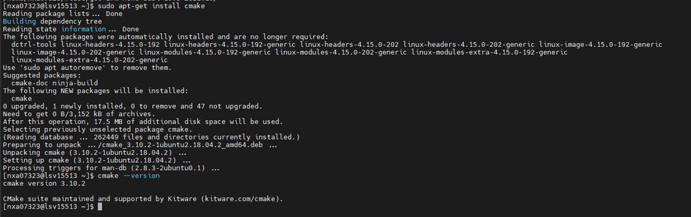

2.3 cmake download and install
Build also need the cmake tool, so use the following command to install cmake and check whether the installation is successful:
sudo apt-get install cmake
cmake –version
Fig 9
Cmake is also ready!

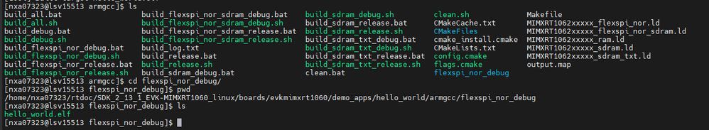

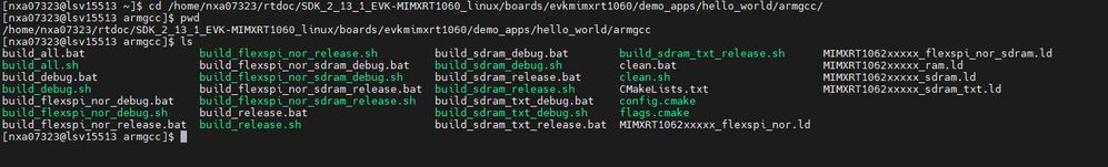

Enter the hello_world gcc path of the SDK:
Fig10
It can be seen that there are many files under the armgcc folder, which are compilable files that generate different images:
build_debugbuild_releasethe linker file is RAM linker, where text and data section is put in internal TCM.
build_flexspi_nor_debug, build_flexspi_nor_release: The linker file is flexspi_nor linker, where text is put in flash and data put in TCM.
build_flexspi_nor_sdram_debug, build_flexspi_nor_sdram_release: The linker file is flexspi_nor_sdram linker, where text is put in flash and data put in SDRAM.
build_sdram_debug, build_sdram_release: The linker file is SDRAM linker, where text is put in internal TCM and data put in SDRAM.
build_sdram_txt_debug, build_sdram_txt_release: The linker file is SDRAM_txt linker, where text is put in SDRAM and data put in OCRAM.

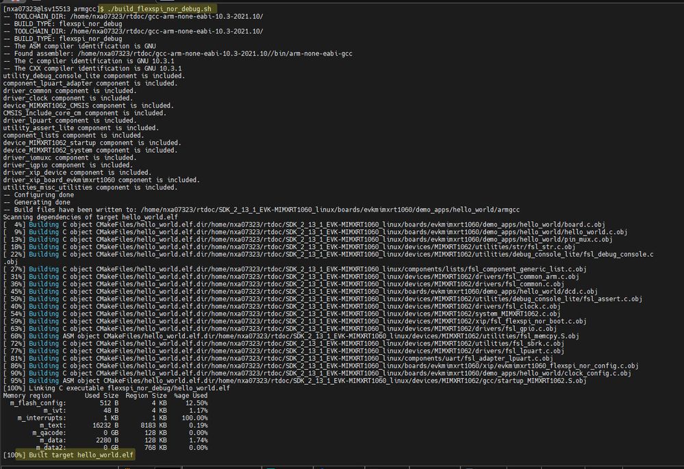

Now, compile build_flexspi_nor_debug.sh, this script will generate flash .elf file, the command is:
./build_flexspi_nor_debug.sh
Fig 11

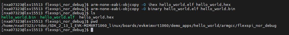

The compiled .elf is placed in the flexspi_nor_debug folder:
Fig 12
Convert the hello_world.elf file to hex and bin for the RT board burning, conversion command is:
arm-none-eabi-objcopy -O ihex hello_world.elf hello_world.hex
arm-none-eabi-objcopy -O binary hello_world.elf hello_world.bin
Fig 13

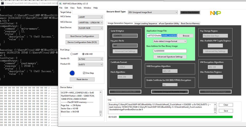

Here use the MCUbootUtility tool to download, and the EVK board enters the serial download mode: SW7 1-OFF, 2-OFF, 3-OFF, 4-ON
Fig 15
After the downloading is finished, EVK board enter the internal boot mode:
SW7 1-OFF,2-OFF,3-ON,4-OFF
Fig 16
We can see, the printf works, it means the Ubuntu Linux build the file works OK.

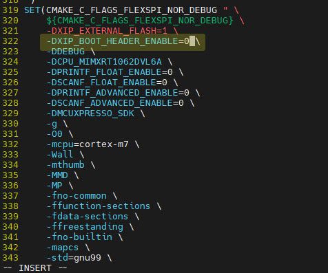

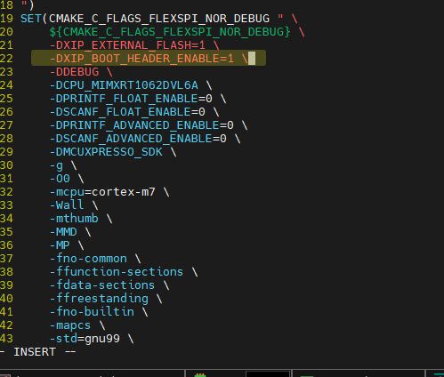

Some customers may think that the executable files to be loaded by some of our tools do not need FCB, so how to realize to generate the app without FCB Linux, here we need to modify the flags.cmake file, the path is:
/home/nxa07323/rtdoc/SDK_2_13_1_EVK-MIMXRT1060_linux/boards/evkmimxrt1060/demo_apps/hello_world/armgcc
Configure BOOT_HEADER_ENABLE=0:
Default is BOOT_HEADER_ENABLE=1(Fig 17), modified to Fig 18:
Fig 17
 Fig18

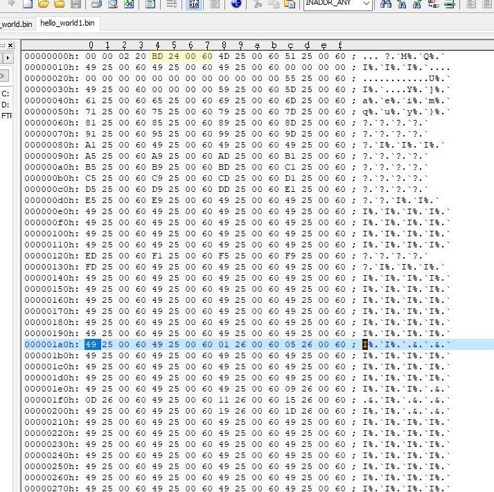

Build again, to generate the .bin, check the .bin file:
Fig 19
We can see that this file is a pure app file that does not contain FCB+IVT. It can be used in occasions that do not require FCB.
