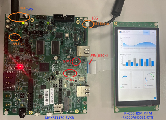

2 Development Setup
  2.1 Software
  2.2 Hardware

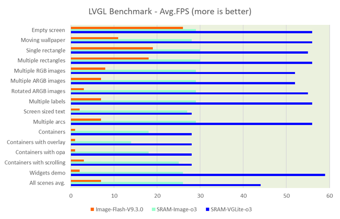

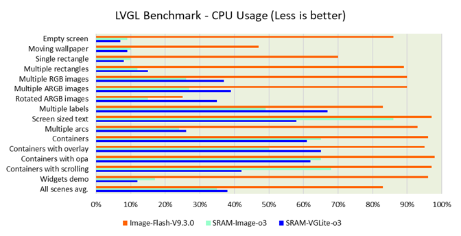

  3.1 Baseline Performance
  3.2 Optimization 1: Compiler Optimization
  3.3 Optimization 2: External SDRAM
  3.4 Optimization 3: VGLite Acceleration
  3.5 Optimization Comparison

This document presents a step-by-step optimization of NXP’s official LVGL benchmark example, with quantified improvements in CPU usage, FPS, render time, and flush time. Taking the Widgets demo as an example:
  • CPU usage dropped from 96% → 12%
  • FPS increased from 2 → 59
These optimization techniques—not limited to LVGL—are broadly applicable to system-level performance tuning on i.MX RT platforms.
