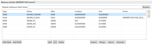

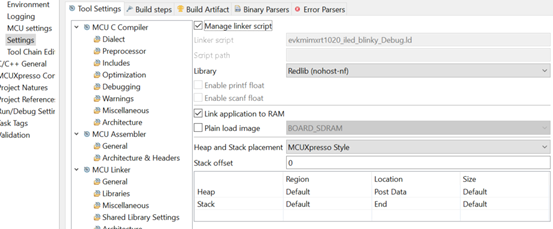

Step 2: Modify the Memory Configuration
Step 3: Select link application to RAM
Step 4. Compile the project. MCUXpresso will generate linker script automatically.
Step 5. Since the code should be linked to RAM, MCUXpresso will not prefix IVT and DCD. We can add these link information to linker script manually. Add below code to .ld file’s head.

Then deselect “Manage linker script” in last screenshot.
Step 6. Recompile the project, IVT/DCD/BOOT_DATA will be add to your project. Then right click the project axf file->Binary Utilities->Create S-record.

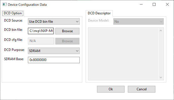

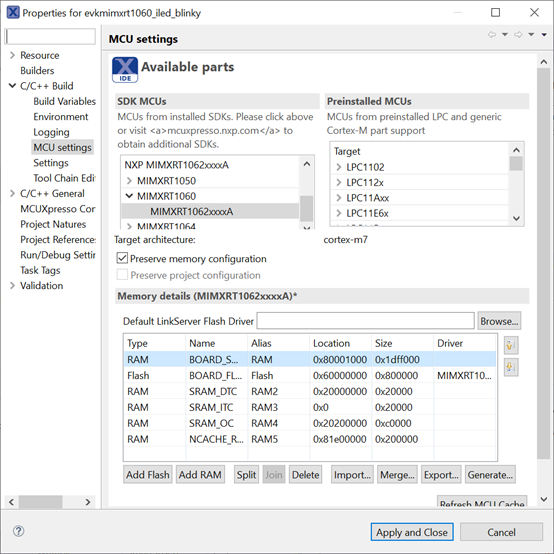

  1. Add DCD by MCUBootUtility
We can also keep the linker script managed by IDE. MCUBootUtility can add head too. Sometimes it is more flexible than other manners.
Step 1. This time BOARD_SDRAM location should be changed to 0x80002000 while the size should be 0x1cff000. This is because the start 8k space in bootable image is saved for IVT and DCD.
Step 2. compile the project and generate the .s19 file.
Step 3. Open MCUBootUtility. In MCUBootUtility, we should first set the Device Configuration Data. Here I use MIMXRT1060_EVK. So I select the DCD bin file in NXP-MCUBootUtility-2.2.0\src\targets\MIMXRT1062.
After that, select the application image file and click All-in-one Action button. MCUBootUtility can do all the work without any manual operation.

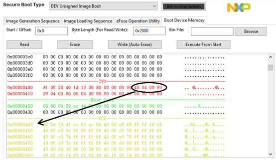

SD card has huge capacity. It's too wasteful to only store boot image. People may ask that can they also create a FAT32 system and store more data file in it? Yes, but you need tool's help. When booting from SD card, ROM code read IVT and DCD from SD card address 0x400. To FAT32, the first 512 bytes in SD is for MBR(MAIN BOOT RECORD). Data in address 0x1c6 in MBR reords the partition start address. If the space from MBR to partition start address is big enough to store boot image, then FAT32 system and boot image can live in peace.
Conclusions:
  1.      To help Boot ROM initialize SDRAM, DCD must be placed at right place and indexed by IVT correctly. When our code seems not work, we should first check IVT and DCD.
  1.      The IVT offset from the base address for each boot device type is defined in the table below. The location of the IVT is the only fixed requirement by the ROM. The remainder or the image memory map is flexible and is determined by the contents of the IVT.

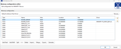

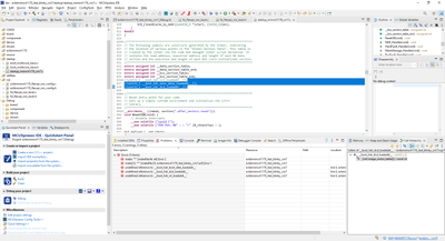

Great article. I have followed all along using MCUExpresso IDE and the RT1176 evalkit.
Although when reach step 6, after hand modifying the script, the build operation crashes giving the following errors:
Here the head of my linker script:

And a snapshot of the memories map:
Thanks for your great help!!
Andrea
How can I do this with IMXRT1064? Should the memory section be modified the same way?
Hi @andrelongo85@jingpan@MustafaEmre,
While booting from SDRAM you have faced error about undefined reference to "_boot_hdr_boot_data_loadder_" variables. Did you resolved it, if yes guide me with the steps to resolve this issue.
Adithya
