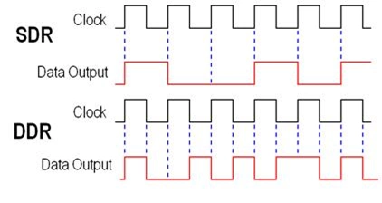

SDR & DDR mode
SDR mode:
In SDR (Single Data transfer Rate) mode, data is only clocked on one edge of the clock (either the rising or falling edge). This means that for SDR to have data being transmitted at X Mbps, the clock bit rate needs to be 2X Mbps.
DDR mode:
For DDR (Dual Data transfer Rate) mode, also known as DTR (Dual Transfer Rate) mode, data is transferred on both the rising and falling edge of the clock. This means data is transmitted at X Mbps only requires the clock bit rate to be X Mbps, hence doubling the bandwidth (as Fig 1 shows).

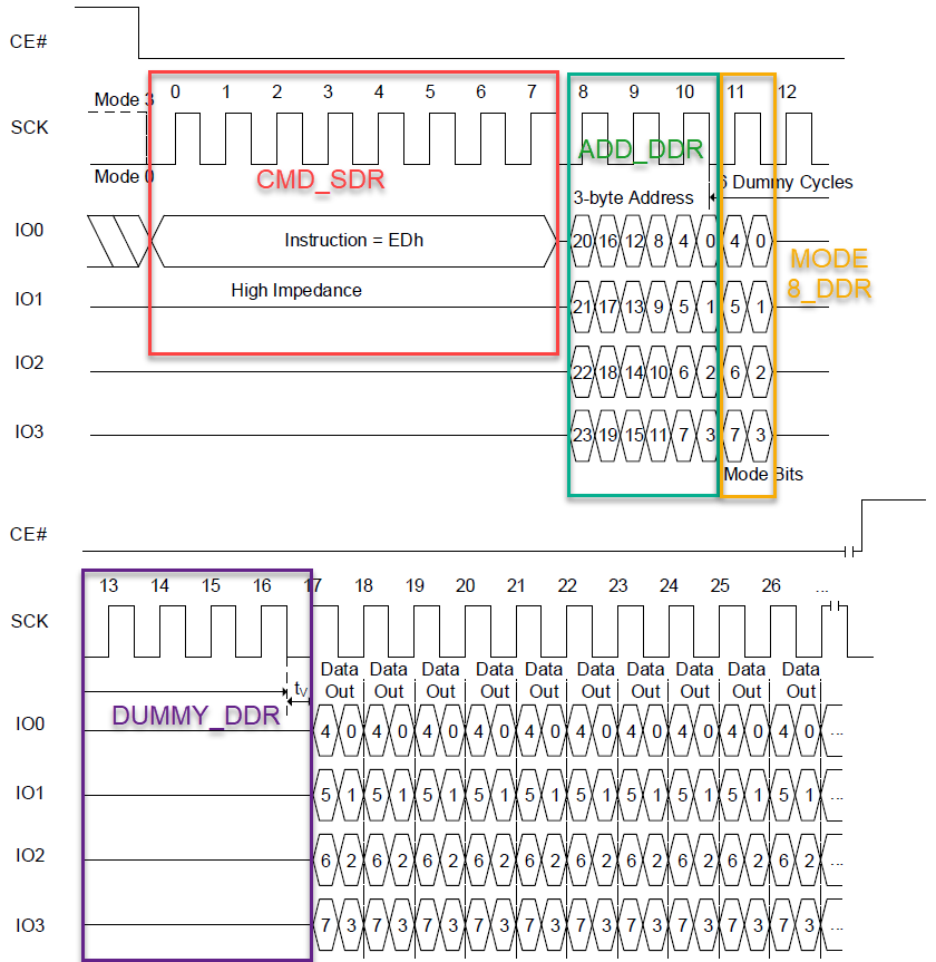

    c)Parase the DDR read command into command sequence.
    The following table shows a template command sequence of DDR Quad IO FAST READ instruction and it's almost matching with the FRQDTR (Fast Read Quad IO DTR) Sequence of IS25WP064 (as Fig 2 shows).
    Fig2 FRQDTR Sequence

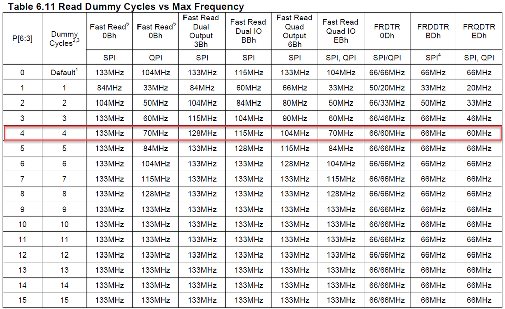

    d)Adjust the dummy cycles.
    The dummy cycles should match with the specific serial clock frequency and the default dummy cycles of the FRQDTR sequence command is 6 (as the below table shows).
    However, when the serial clock frequency is 60MHz, the dummy cycle should change to 4 (as the below table shows).

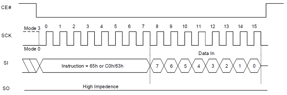

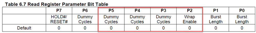

    So it needs to configure [P6:P3] bits of the Read Register (as the below table shows) via adding the SET READ PARAMETERS command sequence(as Fig 3 shows) in FDCB manually.
    Fig 3 SET READ PARAMETERS command sequence
    In further, in DDR mode, the SCLK cycle is double the serial root clock cycle. The operand value should be set as 2N, 2N-1 or 2*N+1 depending on how the dummy cycles defined in the device datasheet.
    In the end, we can get an adjusted FCDB like below.
