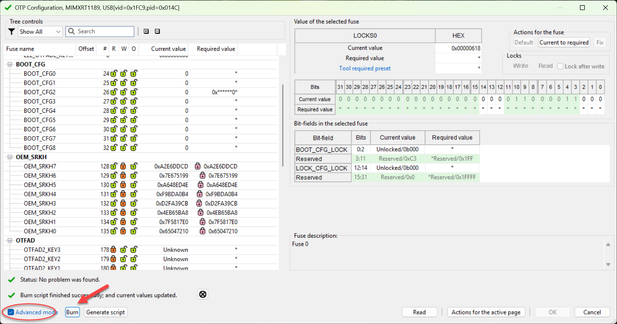

3.1 Generate and Program SRKH Using SPT
The relevant configuration screenshots are shown below:
Figure 1 - SPT SRKH configuration
Figure 2 - SRKH programming confirmation
Figure 3 - SRKH fuse operation
Recommended checkpoints:
  1. Confirm that the SRK table was generated from the correct OEM signing key.
  1. Confirm that SRKH matches the SRK table used by the current project.
  1. Save the configuration record before programming the fuses.
  1. Perform readback verification after programming the fuses.
  1. If Secure Boot will be enabled later, confirm that the SRKH locking policy meets the project manufacturing requirements.
Risk notice: SRKH is a core element of the secure boot chain of trust. Programming or locking must be confirmed by the project security owner in advance.

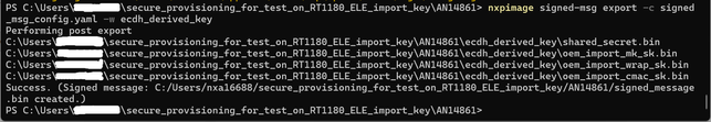

6.6 Generate the Signed Message Binary
After entering the SPT workspace, run:
nxpimage signed-msg export -c signed_msg_config.yaml -w ecdh_derived_key
The result is shown below:
Figure 7 - Export signed message
Expected generated file:
signed_message.bin
ECDH-derived-key intermediate files are also generated in the working directory.
