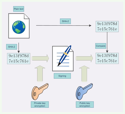

HAB boot
The bootable image is plaintext, and it may be changed after the writing operation of the FlexSPI module. If the digest algorithm obtains the different values will lead to the verification process fails, as the writing operation destroys the integrity of the data, regarding confidentiality, data is stored in plaintext in Serial Nor flash under HAB boot.
Fig1 Signature and verification process

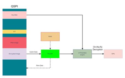

After enabling the Encrypted XIP boot mode, what is the impact on FlexSPI's read and write data operations? The first point is that the read data will be treated as encrypted data and decrypted by the BEE or OTFAD module. However, if a write operation is performed, the BEE or OTFAD module will be bypassed, in another word, the data will be written directly to the Serial Nor flash. in a short, it is not affected by the Encrypted XIP boot mode.
1) Read operation
As shown in Fig 2, the encrypted code and data stored in Serial Nor flash need to be decrypted before they are sent to the CPU for execution. This is also the implementation mechanism of the Encrypted XIP boot mode. To enable the encrypted XIP boot mode, it needs to burn the keys to eFuse, after that, eFuse is impossible to restore, so the test cost seems a bit high, so I recommend you refer to the source code of the 《How to Enable the On-the-fly Decryption》application note to dynamically configure the key of the BEE module and read the encrypted array by DCP from Flash, then compare to plaintext array to verify BEE module participle the decryption flow.

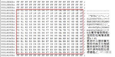

Modify the source code of the above application note, define s_nor_program_buffer [256], then set the values through the following code, and burn them to the 20th sector, the offset address is 0x14000.
for (i = 0; i < 0xFFU; i++)
         s_nor_program_buffer[i] = i;
 status =
  flexspi_nor_flash_page_program(EXAMPLE_FLEXSPI, EXAMPLE_SECTOR * SECTOR_SIZE, (void *)s_nor_program_buffer);
 if (status != kStatus_Success)
  PRINTF("Page program failure !\r\n");
  return -1;
    DCACHE_InvalidateByRange(EXAMPLE_FLEXSPI_AMBA_BASE + EXAMPLE_SECTOR * SECTOR_SIZE, FLASH_PAGE_SIZE);
    memcpy(s_nor_read_buffer, (void *)(EXAMPLE_FLEXSPI_AMBA_BASE + EXAMPLE_SECTOR * SECTOR_SIZE),
           sizeof(s_nor_read_buffer));
    for(uint32_t i = 0; i < 256; i++)
     PRINTF("The %d data in the second region is 0x%x\r\n", i, s_nor_read_buffer[i]);
After the programming finishes, connect to Jlink and use J-flash to check whether the burned array is correct. The results prove that the write operation will bypass the BEE or OTFAD module and write the data directly to the Serial Nor flash, which is consistent with Fig 2.

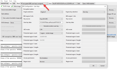

  • Select the XIP encrypted mode in the MCUXpresso Secure Provisioning tool to generate and burn the bootable image of the Blink LED;
Fig5

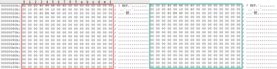

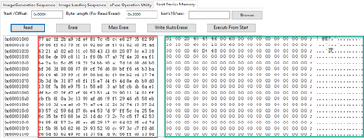

  • Observe the burned image through NXP-MCUBootUtility, you can find that the ciphertext image is very messy when compared to the plaintext image on the right border, so it seems like the NXP-MCUBootUtility can't obtain the plaintext image;
Fig 6
  • Let's observe the ciphertext image in another way, read them through the pyocd command, as shown below;
Fig 7
Open then 9_21_readback.Bin and compare it with the plain text image on the right border, they are the same actually, in other words, the plaintext image was leaked.
Fig 8
