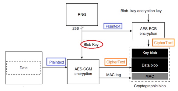

JobRing3
kCAAM_Aes_gcm
kCAAM_RNG
kCAAM_Red-Block
kCAAM_Black-Block
kCAAM_CRC
RunAesGcmExamples(base,&caamHandle);
RunRngExample(base, &caamHandle);
RedBlobExample(base, &caamHandle);
BlackBlobExample(base, &caamHandle);
RunCrcExamples(base, &caamHandle);
