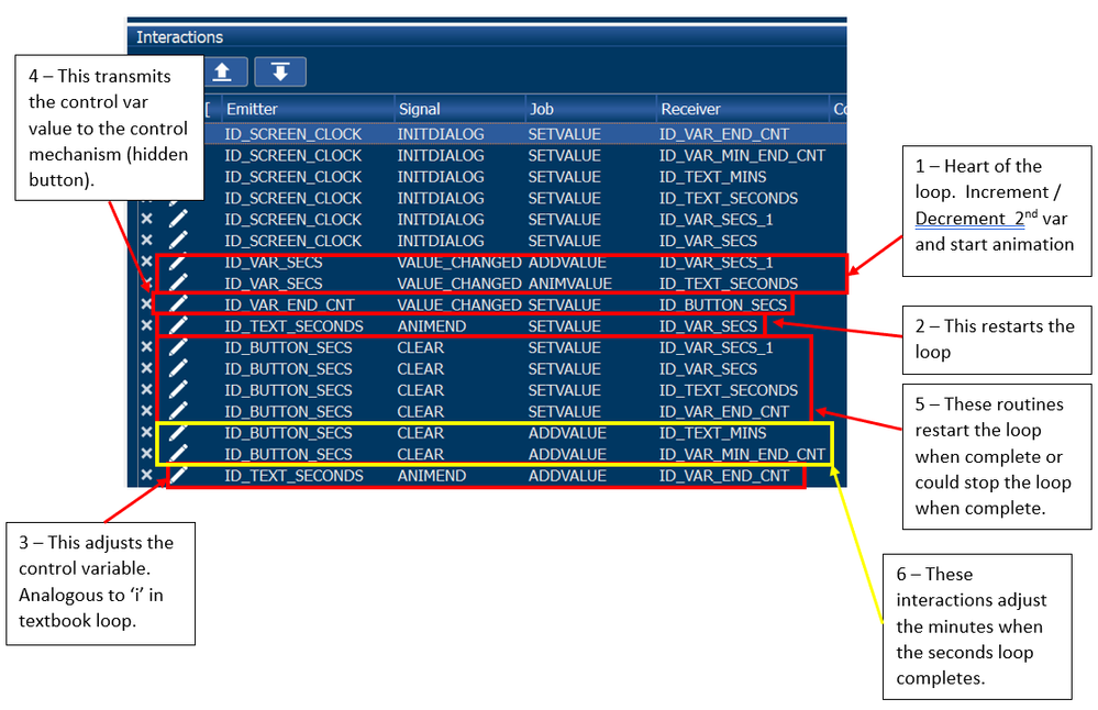

Method 2:  Animation Objects
When implementing a real-time clock using animation objects, it is necessary to implement a loop.  This could be done outside of the AppWizard GUI (in your code) but because the timing precision can't be guaranteed, it's just as easy to implement a loop in the AppWizard GUI if you know how (it isn't very intuitive as to how to do this). Before examining the interactions to do this, let's look at the variables and objects needed to do this.
  1. ID_VAR_SECS - This variable holds the current seconds value.
  2. ID_VAR_SECS_1 - This variable holds the next second value.
  3. ID_TEXT_SECONDS - Text box that displays the current seconds value.
  4. ID_END_CNT - Variable that holds the value at which the seconds rolls over and increments the minute count
  5. ID_TEXT_MINS - Text box that holds the current minute count.
  6. ID_MIN_END_CNT - Variable that holds the value at which the minutes rolls over (which would also increment the hour count if the hours were implemented).
  7. ID_BUTTON_SECS - This is a hidden button that initiates actions when the seconds variable has reached the end count.
Now, here are the interactions used to implement the clock feature using animation interactions.
  1. The heart of the loop are the interactions triggered by ID_VAR_SECS.
    1. ID_VAR_SECS -> ID_VAR_SECS_1:  When ID_VAR_SECS changes, it needs to add one to ID_VAR_SECS_1 so that the animation will animate to one second from the current time.
    2. ID_VAR_SECS -> ID_TEXT_SECONDS:  When ID_VAR_SECS changes, it also needs to start the animation from the current value to the next second (ID_VAR_SECS_1).
  2. A very essential part of the loop is ensuring the animation restarts every time.  So ID_TEXT_SECONDS needs to change the value of ID_VAR_SECS when the animation ends. ID_VAR_SECS is changed to the current time value, ID_VAR_SECS_1.
  3. When the ID_TEXT_SECONDS animation ends, it must also decrement the ID_VAR_END_CNT variable.  This is analogous to the control variable of a "For" loop being updated. This is done using the ADDVALUE job, adding '-1' to the variable, ID_VAR_END_CNT.
  4. When ID_VAR_END_CNT changes, it updates the hidden button, ID_BUTTON_SECS, with the new value.  This is analogous to a "For" loop checking whether its control variable is still within its limits.
  5. The interactions in group 5 are interactions that restart the loop when the seconds reach the count that we desire.  When the loop is restarted, the following actions must be taken:
    1. Set ID_VAR_SECS and ID_VAR_SECS_1 to the initial value for the next loop ('0' in this case).  Note that ID_VAR_SECS_1 MUST be set before ID_VAR_SECS.  Additionally, if the loop is to continue, ID_VAR_SECS and ID_VAR_SECS_1 must be set to the same value.
    2. ID_TEXT_SECONDS is set to the initial value.  If this isn't done, then the text box will try to animate from the final value to the initial value and then will look "weird".
    3. ID_VAR_END_CNT is reset to its initial value (60 in this case).
  6. ID_BUTTON_SECS is also responsible for updating the minutes values.  In this case, it's incrementing the ID_TEXT_MINS value (counting up in minutes) and decrementing the ID_VAR_MIN_END_CNT

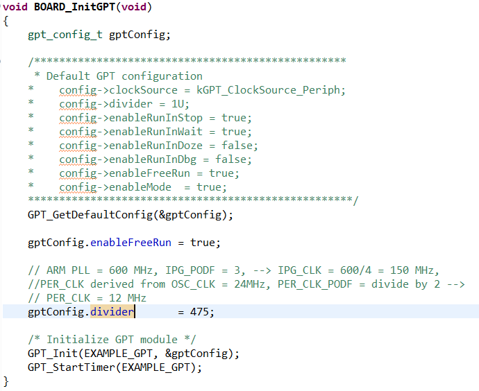

Adjusting the time of an animation object
The animation object (as well as other emWin objects) use the GUI_X_DELAY function for timing.  It is up to the host software to implement this function.  In the i.MX RT examples, the General Purpose Timer (GPT) is used for this timer.  So how the GPT is configured will affect the timing of the application and the how fast or slow the animations run. The GPT is configured in the function BOARD_InitGPT() which resides in the main source file.  The recommended way to adjust the speed of the timer is by changing the divider value to the GPT.
