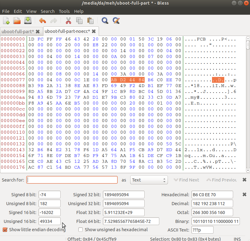

it seems that we have a problem with the FCB data structure written on NAND, on boards based on i.MX6ULL rev1.0 14x14 EVK, booting from a Micron MT29F32G08CBADAWP-12IT:D NAND.
From some point on, the data seems to be wrong; can anyone with experience on the subject confirm our analysis?
We tried using multiple versions of kobs-ng, including the latest from github and the one in the SDK from NXP.
What we see in the NAND, with a nanddump -o -a /dev/mtd0 is as follow (we've removed the first 0x15 bytes to be aligned with the FCB structure described in chapter 8.5.2.3 of the i.MX 6ULL Applications Processor Reference Manual:
Everything is ok up to BadBlockMarkerByte (position 0x7c, value 7692); after that, there should be 0 for BadBlockMarkerStartBit but as you can see everthing from there on seems to be wrong.
We are especially concerned about BCHType that should be 1, but is wrong and we suspect it makes ECC flipbits recovery impossible, for the ROM.

2,889 Views
da1
it seems that the "missing" data began at offset 0xC5, and the values there are correct. What it's not clear is why there's this (BCH?) data so soon; we expected the Block0 size to be 512 bytes for i.MX6ULL.
