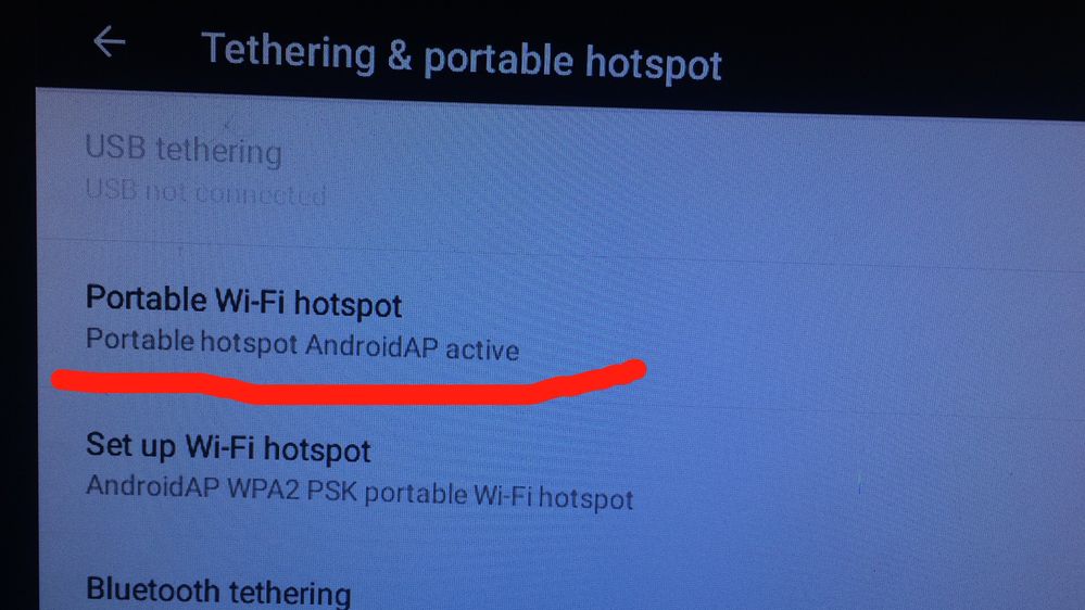

first,turn on the Portable Wi-Fi hotspot button to enable hotspot,but hotspot keep the status,as shown below redline mark

second,if i input command "hostapd -e /data/misc/wifi/entropy.bin /data/misc/wifi/hostapd.conf" to terminal by serial port ,the hotspot is really tuned on,
log:
hostapd -e /data/misc/wifi/entropy.bin /data/misc/wifi/hostapd.conf <

==> rssi_level:0, rate_bitmap:0x0000000000000000, shortGIrate=0
==> bw:0, ignore_bw:0x0
RTW: IQK offload finish in 30ms
RTW: rtw_cfg80211_indicate_connect(wlan0)
RTW: assoc success
IPv6: ADDRCONF(NETDEV_CHANGE): wlan0: link becomes ready
RTW: rtw_ndev_notifier_call(wlan0) state:4
RTW: cfg80211_rtw_change_bss(wlan0)
RTW: cfg80211_rtw_add_key(wlan0) adding key for (null)
RTW: cipher=0xfac04
RTW: key_len=0x10
RTW: seq_len=0x0
RTW: key_index=1
RTW: pairwise=0
RTW: rtw_cfg80211_ap_set_encryption
RTW: rtw_cfg80211_ap_set_encryption, set group_key, CCMP
RTW: rtw_ap_set_group_key
RTW: set group key camid:0, addr:0c:8c:24:6d:e4:ba, kid:1, type:AES
RTW: cfg80211_rtw_set_default_key(wlan0) key_index=1, unicast=0, multicast=1
RTW: cfg80211_rtw_set_mac_acl(wlan0) acl_policy:0, entry_num:0
RTW: WARN cfg80211_rtw_set_mac_acl(wlan0) acl_policy:0 with no entry
RTW: rtw_set_macaddr_acl(wlan0) mode=0
RTW: SetHwReg8812A, 5544, RCR= f400608e
but , i don't know how to solve it,please help me
thanks
4,173 Views
diegoadrian
I apologize for the delay.
The hotspot from Android only works in one way. It can only be transceiver or sender, not both. You can try to use a GSM module to have a mobile internet connection and then use the hotspot feature. However this out of our scope, I apologize for the inconveniences this could give you.
Diego.
