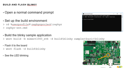

Hi @Daniel_Jankins ,
  Do you try to use the west to flash the code like the following method:
In the old-time, we use the west to download the code successfully.
Wish it helps you!
