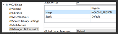

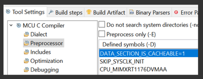

Hello, I am using the USB_CDC_VCOM_BM_CM7 code, but I have not been able to trigger the receive and send interrupt. I used my own development board with the usb3.0 driver and RT1170 as the slave. The enumeration can be successful, but it has been unable to reach the data transmission stage. Trigger the interrupt of RT1170. Can CDC_VCOM_BM_CM7 be used directly? Is there anything that needs to be modified?

If data section is cacheable, need to check two point:
1. DATA_SECTION_IS_CACHEABLE=1 must be added into project.
2. Heap used by USB stack should be placed into non-cacheable region.
Please refer to picture below, after apply the two change, it now works.
Hui_Ma_0-1664416711850.pngHui_Ma_0-1664416711850.pngHui_Ma_1-1664416734824.pngHui_Ma_1-1664416734824.png
Wish it helps.
Wish it helps.
8,958 Views
eao
Thank you very much, this answer solves my problem.
