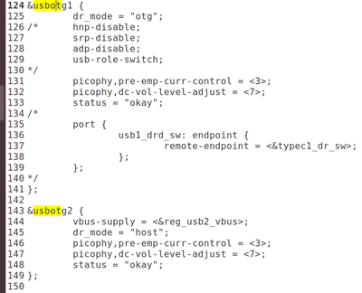

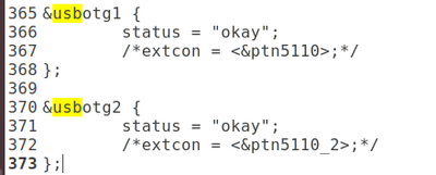

weidong_sun
   if there is no PD chip for USB type-c, and only use USB OTG (or device) mode. modify dts in u-boot and kernel.
---u-boot
&usbotg1 {
status = "okay";
/*extcon = <&ptn5110>;*/
--Kernel.
&usbotg1 {
dr_mode = "otg";
/* hnp-disable;
srp-disable;
adp-disable;
usb-role-switch;
picophy,pre-emp-curr-control = <3>;
picophy,dc-vol-level-adjust = <7>;
status = "okay";
port {
usb1_drd_sw: endpoint {
remote-endpoint = <&typec1_dr_sw>;
Try it, please!
Have a nice day!
B.R,
Weidong
