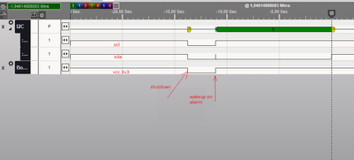

I disabled the second i2c connected device cs43l21 and noticed a strange behavior about i2c.
Tested with oscilloscope:
- General case: in a cold boot case there is some work on i2c on u-boot stage and kernel probe drivers stage.
- Issue case: there is no i2c actions on u-boot stage and on kernel probe drivers stage.
Also attached a plain from logic analyzer when the ptn5110 is single on i2c
Also if there would the the second i2c device (cs43l21) then it could work fine somehow.
The issue is that SDA is kept down for about 10 seconds
4,575 Views

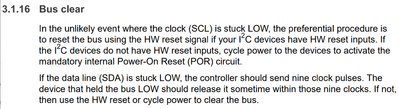

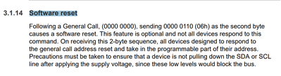

From the oscilloscope test result, the i2c bus SDA stuck in LOW, which we call it has been locked up.
There are two ways to avoid such issue:
1. Connect slave device which has RESET pin(ptn5110 not, but cs43l21 has)
2.Send nine clock pluse when SDA stuck in LOW
Reference: https://www.nxp.com/docs/en/user-guide/UM10204.pdf
