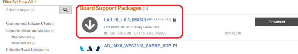

You can download the binary release to try
For avoid the auto blank, you can give the kernel parameters consoleblank=0 by uboot boot args, which is in the Linux source tree document Documentation\kernel-parameters.txt
