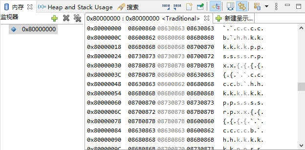

I have ever read and written sdram IS45S16160J correctly on a test board, just with rt1176 and the sdram, and I found it is not sensitive to the timing parameters, with modifying the sdramconfig.memsize_kbytes and sdramconfig.portSize, it can work well. But it can't work on our product board, so I guess it may be because of some hardware reason.
Also, I tried to modify the timing parameters according to the datasheet, but the sdram will still fail to read and write, and the error data seems same as before like the following.
error dataerror data
Do you have other ideas for us to check? Thanks.

   From your picture, the external SDRAM seems not working.

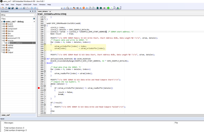

  Please debug this code:
Step by step, check the sdram_writeBuffer and sdram, sdram_readBuffer array.
make sure the writebuffer is 0,1,2,3...
Then, sdram arry write it, then readout the sdram to check it.

I have checked that the sdram_writeBuffer is right, the value of sdram array is wrong from the 'Memory Monitor', and then, sdram_readBuffer can read back the wrong value.
So, it is a write error problem, what's the possible reason about that?

  It means your SDRAM totally not work.
  So, need to check your SDRAM RT related schematic, and the SDRAM initialization code.
   Just as I told you, if you are not convenient, create the private case, share the schematic, the SDRAM modified project to me, then I will help you to check it in details.
