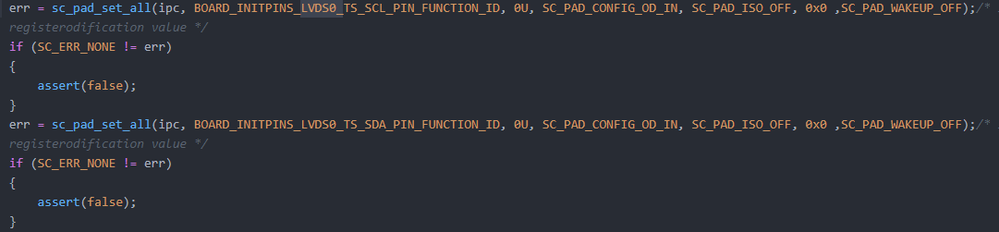

Instead of trying to do it on Linux, i went with the easier step first. I tried to move lvds0(dpu 0) instead of lvds1(dpu1).

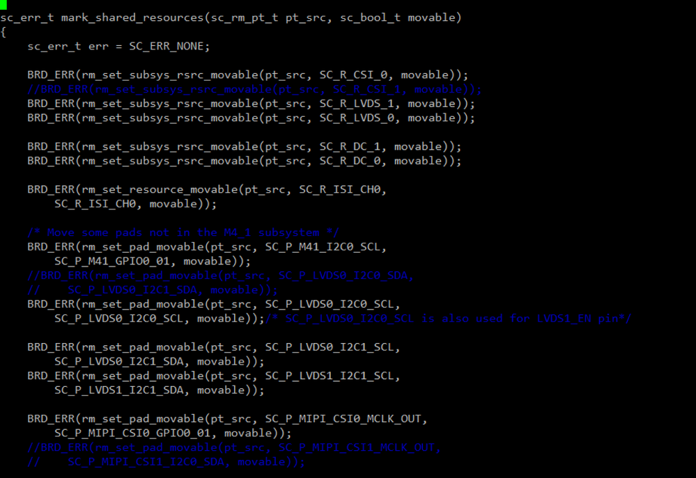

What i have done are:-
1. Set all related rsrc to movable in scfw
2. commented out #define USE_LVDS1 in isi_config.h and added as below in pin_mux.c
   At this point, m41 is able to display
