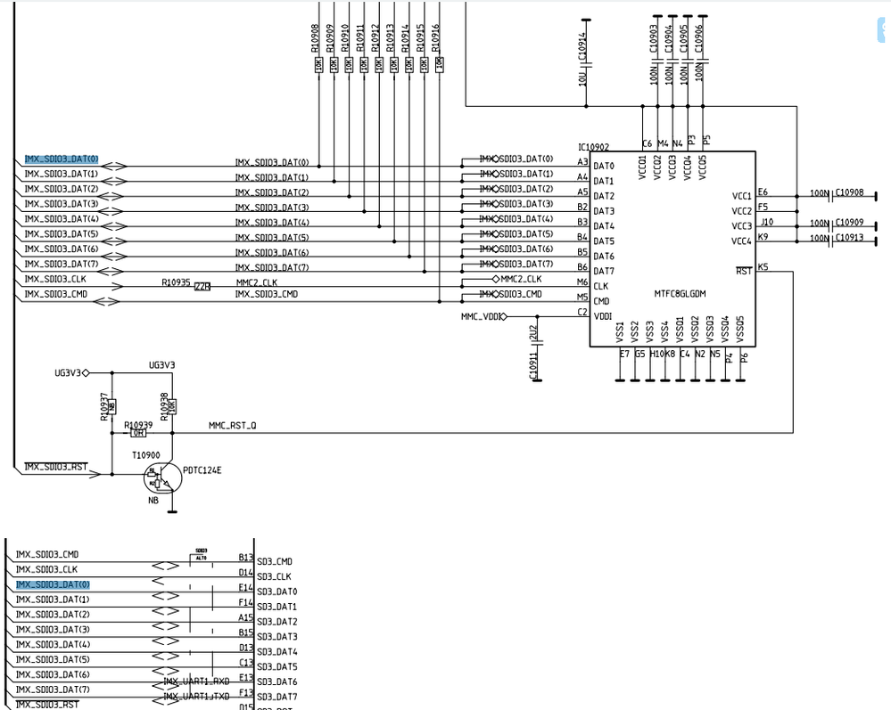

eddyliu
Hi Grace Si,
Thanks for your response. In my Log. No eMMC device is found. But I am wondering why eMMC device can not be found on my hardware board. On my hardware board eMMC device layout is same as SABRE-AI_DualLite_CPUcard which is EV kit of freescale:
On my hardware board:
On SABRE-AI_DualLite_CPUcard:
I can make sure eMMC device is working on my hardware board because QNX system can run my hardware board which use eMMC device as boot program storage space.

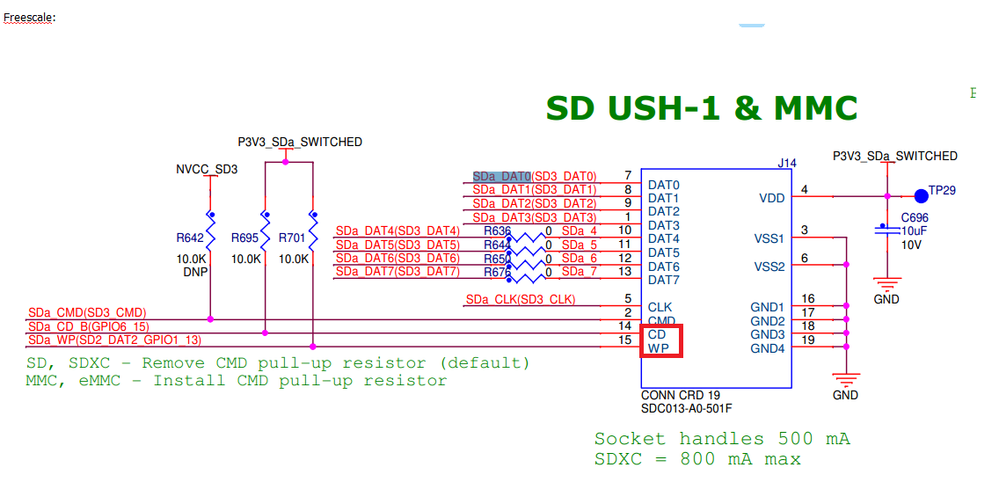

Hi Eddy,
Except pin CLK, CMD, DAT0-7, you need also check whether SD3_CD and SD3_WP are correctly muxed.
static iomux_v3_cfg_t mx6dl_sabreauto_pads[] = {
/* SD3 */
MX6DL_PAD_SD3_CLK__USDHC3_CLK_50MHZ,
MX6DL_PAD_SD3_CMD__USDHC3_CMD_50MHZ,
MX6DL_PAD_SD3_DAT0__USDHC3_DAT0_50MHZ,
MX6DL_PAD_SD3_DAT1__USDHC3_DAT1_50MHZ,
MX6DL_PAD_SD3_DAT2__USDHC3_DAT2_50MHZ,
MX6DL_PAD_SD3_DAT3__USDHC3_DAT3_50MHZ,
MX6DL_PAD_SD3_DAT4__USDHC3_DAT4_50MHZ,
MX6DL_PAD_SD3_DAT5__USDHC3_DAT5_50MHZ,
MX6DL_PAD_SD3_DAT6__USDHC3_DAT6_50MHZ,
MX6DL_PAD_SD3_DAT7__USDHC3_DAT7_50MHZ,
/* SD3 VSelect */
MX6DL_PAD_GPIO_18__USDHC3_VSELECT,
/* SD3_CD and SD3_WP */
MX6DL_PAD_NANDF_CS2__GPIO_6_15,
MX6DL_PAD_SD2_DAT2__GPIO_1_13,

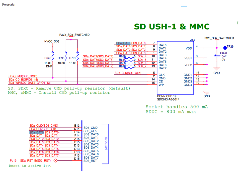

eddyliu
Hi Grace Si,
Under your reminding. I checked pins between my hardware board and freescale board except pins CLK, CMD and DAT0-7. I am notified SD3_CD and SD3_WP is not existed on my hardware board, while RST pin is on my hardware board which is not existed on freescale board. What does this two pins do? Is it necessary for eMMC or eMMC has many different hardware interface?
I check eMMC hardware interface on line which is same as my hardware board

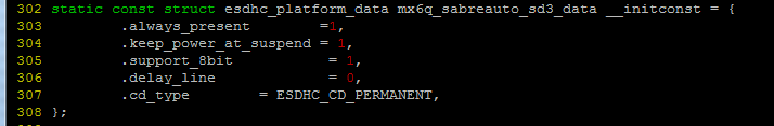

Hi Eddy,
If your board is not same as FSL board, you need modify mx6q_sabreauto_sd3_data in
/arch/arm/mach-mx6/board-mx6q_sabreauto.c
original:
static const struct esdhc_platform_data mx6q_sabreauto_sd3_data __initconst = {
  .cd_gpio = SABREAUTO_SD3_CD,
  .wp_gpio = SABREAUTO_SD3_WP,
  .keep_power_at_suspend = 1,
  .support_18v = 1,
  .support_8bit = 1,
  .delay_line = 0,
  .platform_pad_change = plt_sd_pad_change,
change to ->
  .always_present = 1,
  .support_8bit = 1,
  .delay_line = 0,
  .cd_type = ESDHC_CD_PERMANENT,
Grace

GraceH
Senior Contributor II
Hi Eddy,
CD( card detect) pin and WP (write protect) pin are needed for removable SD card, but NOT needed for non-removable eMMC.
Grace

GraceH
In FSL board, SD3 is configured for removable card, so CD pin and WP pin are defined in mx6q_sabreauto_sd3. If you use SD3 as non-removable, you must modify the structure of mx6q_sabreauto_sd3.
Grace

Hi Grace,
I have modified data struct mx6q_sabreauto_sd3_data in /arch/arm/mach-mx6/board-mx6q_sabreauto.c:
and compiled linux kernel using command below:
Header 1
#make ARCH=arm CROSS_COMPILE=/opt/freescale/usr/local/gcc-4.6.2-glibc-2.13-linaro-multilib-2011.12/fsl-linaro-toolchain/bin/arm-none-linux-gnueabi- distclean
#make ARCH=arm CROSS_COMPILE=/opt/freescale/usr/local/gcc-4.6.2-glibc-2.13-linaro-multilib-2011.12/fsl-linaro-toolchain/bin/arm-none-linux-gnueabi- imx6_updater_defconfig
#make ARCH=arm CROSS_COMPILE=/opt/freescale/usr/local/gcc-4.6.2-glibc-2.13-linaro-multilib-2011.12/fsl-linaro-toolchain/bin/arm-none-linux-gnueabi- uImage
but still no eMMC device is found after uboot and uImage is downloaded by MFGtools:

If you use 6DL SarbeSD, you should modify /arch/arm/mach-mx6/board-mx6q_sabresd.c. In your post, you said you compared SABRE-AI_DualLite_CPUcard,  If you use SarbeSD config, you should compare SarbeSD reference design.

With your patiently direction, I modified file board-mx6_sabresd.c. Now eMMC device can be found:
