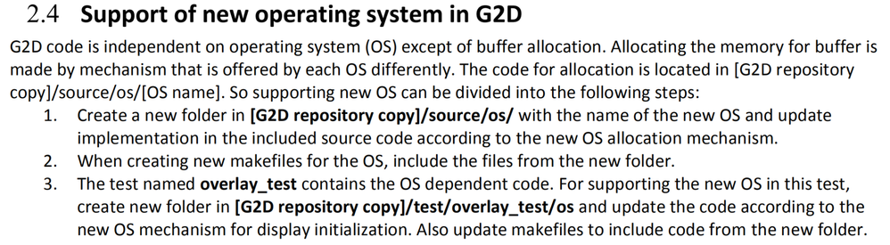

Dear Sir,
I got below info from graphics user's guide.
1:Could you show below G2D source code?
2:where can I find G2D HAL code ?
3:I found libg2d.so from path:root/vendor/nxp/fsl-proprietary/fsl-dpu/lib/libg2.so.
what is it used for ? can you show me source code ?
4:from i.mx8,g2d is replaced by dpu,right ?
5:where can I find the dpu kernel & hal code base ?
6:which android & kernel version support dpu ? please show the source code link.
Thank you.

Hi Keil
for sources one can refer to  Chapter 5 Graphics Linux Manual
and sect.5.1.5 Source Code Structure included in Linux 4.19.35_1.1.0 Documentation
As described in sect.5.1.1 Introduction :
"The GPU driver kernel module source is in the kernel source tree, but the libraries are
delivered as binary only."
Please also check i.MX_Graphics_User's_Guide.pdf,
igor
