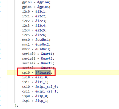

On NXP EVK board, the flash is under flexspi node and we also use CONFIG_MTD_SPI_NOR=y
Have you modify the spi0 in dtsi?

Now there are two types of flash chips on my development board. The original one is under the flexspi node, which has not been changed and can be recognized normally. In addition, the flash chip I added is under the ecspi node, and the previous ecspi node configuration has been sent to you
In addition, how should I configure this dtsi you mentioned

You can try to add:
spi1=&ecspi2;
4,788件の閲覧回数
qwerqq
I tried here, there is no effect, is there any other place to cause the compiler driver =y is not recognized?
