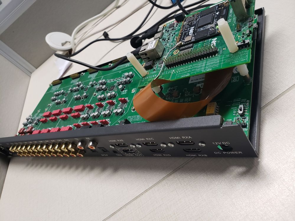

   l try to start i.MX 8M Audio Framework  by docment ,named i.MX 8M Audio Framework Customer Post Processing SDK User’s Guide.

device /sys/devices/platform/bb800000.pci/pci0000:00/0000:00:00.0/ppp is not ready.
in fact ,dectect node via "echo -n "PUT pipeline1/volume.elt/volume0/gain=0.6" > /sys/devices/platform/bb800000.pci/pci0000:00/0000:00:00.0/ppp" , but response always is ERROR.
how does l fix it ? thanks

Hello Zhao,
Do you have connected the Audio board to the MX8MMini? this kinds of issues give you when you have not connected.

run_zhao
Hi,Bio
      l have confirmed that connect ribbon cable from J1001 of i.MX8MMini EVK board to J2500 of Audio board.
but audio board have not inserted DC powerd , not connect HDMI output of DVD/Blu-Ray player to HDMI RXC input port of Audio board.
     Is it necessary to supply power to audio board separately?
     thanks
2,479 Views
Bio_TICFSL
Yes, you need power the Audio board
HDMI OUT to TV
HDMI RXC to blueray
2,479 Views
run_zhao
Ok,Thanks for your support.
