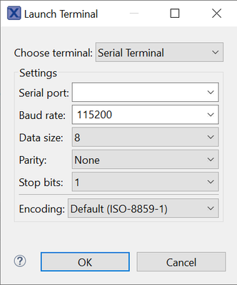

kar1
I use Imx1021 of NXP demo board on Windows 10.
When using Mcuxpresso, nothing is printed in terminal view.
Itried also alternatives with teraterm, same issue.
I changed port configuration number in windows (exemple COM17, COM9…) nothing also.
I cannot use console view in Mcuxpresso.
Does somebody get idea about issue of terminal?

kar1
hello,
yes sure, I followed the getting started document.
and launch (in image capture the setting of the terminal (using Windows 11).
I will follow again the getting started document,
strange this behavior, but seems that others members of this forum had same issue to log to terminal!
can it come from cable to connect to USB or others..., windows 11 settings...  no idea for the moment...
I will try to set a new environment on my Mcuxpresso ... but I am not sure it will help more...
I tried also to set new com in windows see captured images-periph manager) also relaunch new environment with "hello_world" but till same issue.
When trying to change Com port in windows, error message appear "port is used by other application" is triggered (see capture 2024-03-05 080715.png)
