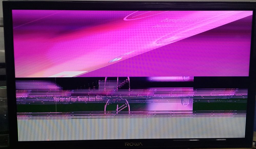

rajucm
Hi Qiang Li,
Along the same lines, I am connecting the lcd interface to RGB Analogue converter ADV7123. But I cant seem to find the parameters to fill for fb_videomode.
http://www.analog.com/en/products/digital-to-analog-converters/da-converters/adv7123.html
I am aiming for a 640x480 @ 60 Hz output.
Help would be greatly appreciated. Thank You.
Raju
12,751 Views
rajucm
Hi Qiang Li,
I am using these figures below.
static struct fb_videomode lcdif_modedb[] = {
    "ADV-WVGA", 60, 800, 480, 28800, 89, 164, 23, 10, 10, 10,
    FB_SYNC_CLK_LAT_FALL,
    FB_VMODE_NONINTERLACED,
    0,},
I get some output on the TV hooked up to the ADV7123 RGB out with the above values. Please help. Any changes in the values result in a blue screen. Please help. Many Thanks.
