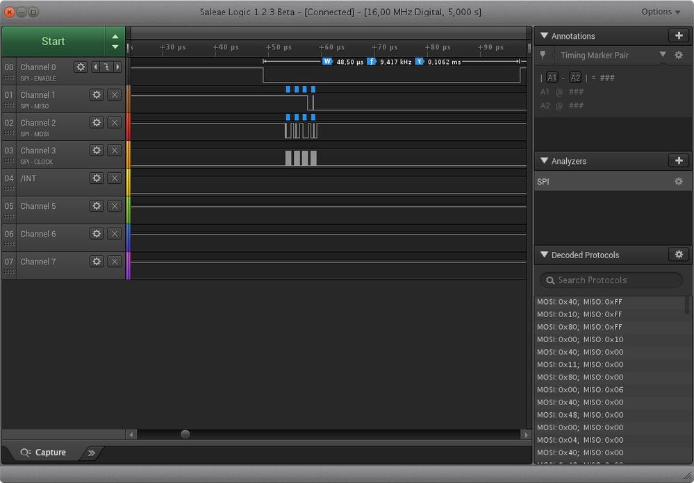

I try to write a SPI protocol driver (kernel space) using Linux 3.10.70 kernel. The SPI transfer works so far, but serveral transfers to read or write registers on the  slave chips have long delays. Looking at the SPI signals I see that the CS signal is much too long, and here are also small waits between the transfered bytes.
I use 8MHz SPI clock speed.
The registers are all 8bit and one transaction consists of 4 bytes:
Write:
<addr write ctrl> <register addr> <data write ctrl> <data>
Read:
<addr write ctrl> <register addr> <data read ctrl> <data>
Example data read:

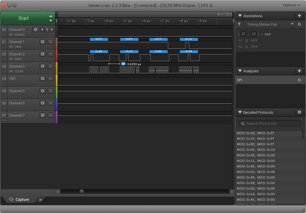

Complete transaction (same read):
You see that the chip select is much longer activ as needed, about 4us before SPI clock starts and about 40 us after the transaction did end.

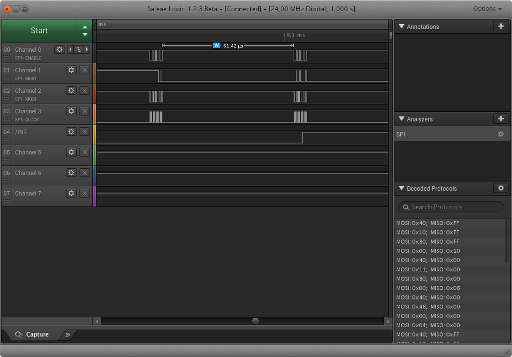

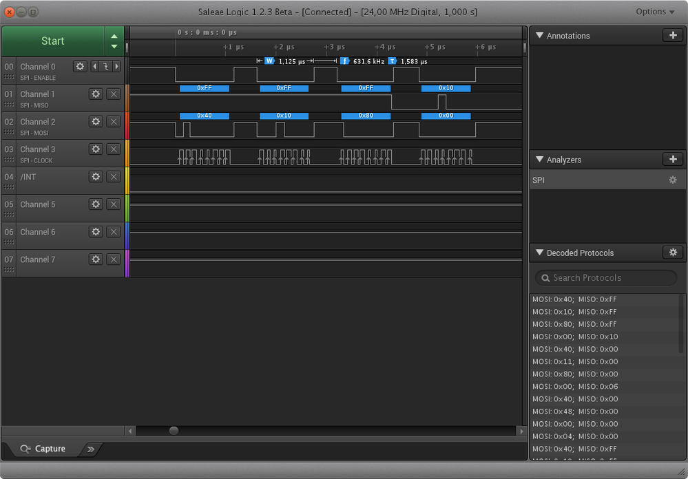

the issue with the long chip select is fixed, it was a misconfiguration of the chipselect pin.
We are using PAD_KEY_ROW1 for it. It was configured as GPIO and the GPIO was given to the SPI master driver as
chip select. This caused the long activation of the signal (Still unknown why - do you haven an idea ?).
I reconfigured the PAD to act as ECSPI1_SS0 and now  the SPI transfer itself looks much better:
But the performance of multiple short transactions seems to be still very poor. I see 45 - 65 us delay between 2 transaction which are
2 register reads with only 2  if test for bits in the first read result between. Also writes  have the same delay between single transactions.
Is this performance normal for the ECSPI inside the linux kernel ?
