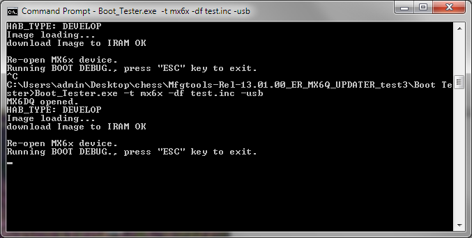

Let's try the following. I'm attaching a boot tester program. After you flash your 5.0 image with the 4.4.2 tool, set the boot mode to eMMC and connect the USB cable to your PC. As you said it won't boot and will go to the serial download mode. Do not launch the mfgtool. Instead, using the utility attached, from a DOS window, type:
    Boot_Tester.exe -t mx6x -df test.inc
This will connect to the board and will read the boot log. It should tell us which device it's trying to boot from and why the boot process failed. Please copy paste that output and attach it here.
Meanwhile I'll look into the logs you attached some more and see if I can see any issues.

jamespieterick
Hi Kursad,
When I ran the tool this is what was printed to the command prompt window:
Microsoft Windows [Version 6.1.7601]
Copyright (c) 2009 Microsoft Corporation.  All rights reserved.
C:\Users\admin>cd C:\Users\admin\Desktop\chess\Mfgtools-Rel-13.01.00_ER_MX6Q_UPD
ATER_test3\Boot Tester
C:\Users\admin\Desktop\chess\Mfgtools-Rel-13.01.00_ER_MX6Q_UPDATER_test3\Boot Te
ster>Boot_Tester.exe -t mx6x -df test.inc
MX6DQ opened.
HAB_TYPE: DEVELOP
Image loading...
download Image to IRAM OK
Re-open MX6x device.
Running BOOT DEBUG., press "ESC" key to exit.
Jim Pieterick

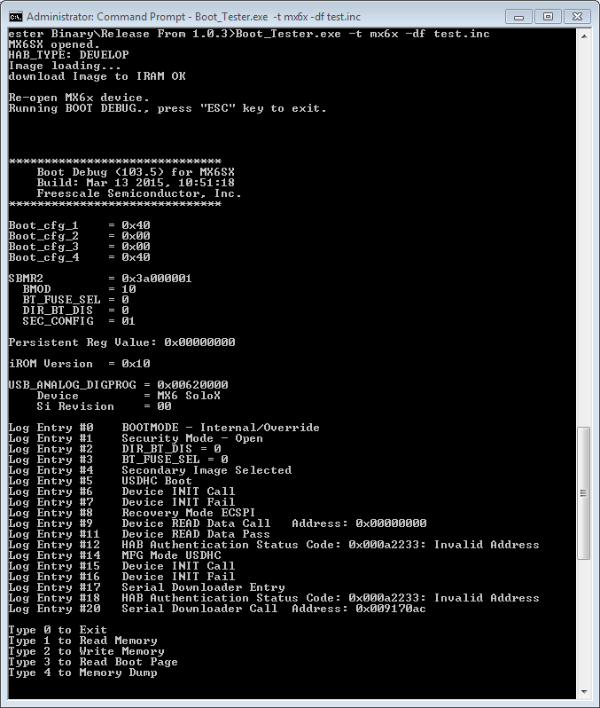

It doesn't show the boot log. Can you put the board in serial download mode and see if you can see the boot log that way?
You should see something like this:

KursadOney
Jim,
According to this log, the proper device is selected but there is no bootable image. This may mean either:
* u-boot image is not valid.
* while u-boot is written to emmc, somehow it gets overwritten or corrupted.
First let's test the first one since it's easier to rule out. Can you replace the u-boot-6q.imx file with a known good u-boot-6q.imx (from your 4.4.2 build) and see you get get it to work?
If not we have to review the details of the procedure and see if there is anything that could cause an overwrite. One thing I noticed is the 5.0 mfgtool does the partitioning before it writes u-boot. You can compare the ucl2.xml files and see the order of that. Maybe changing that order might be it.
