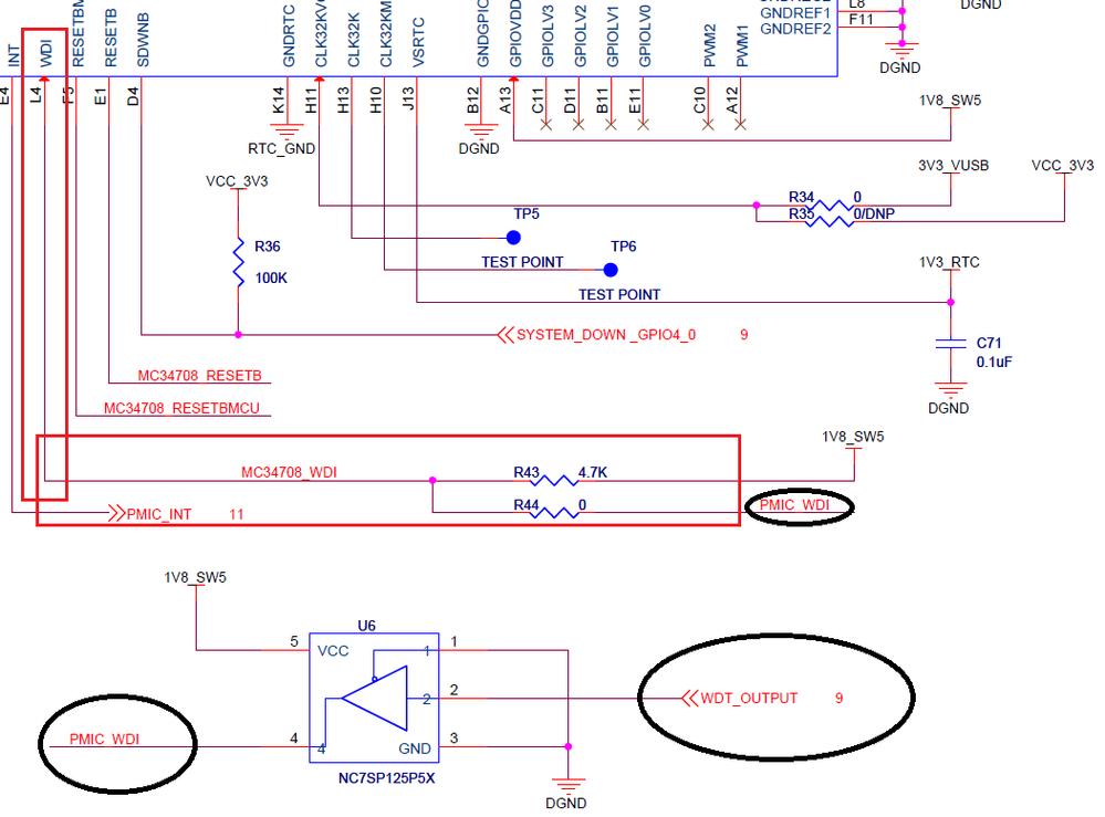

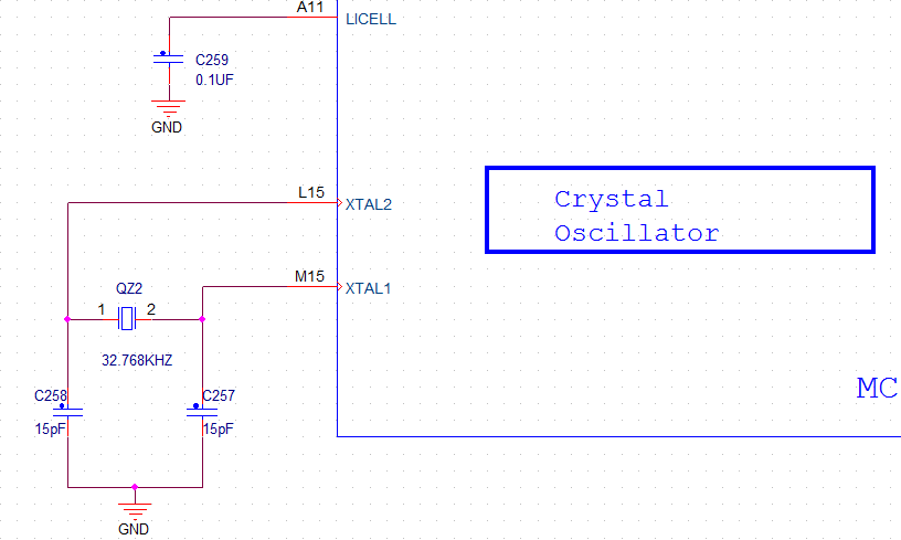

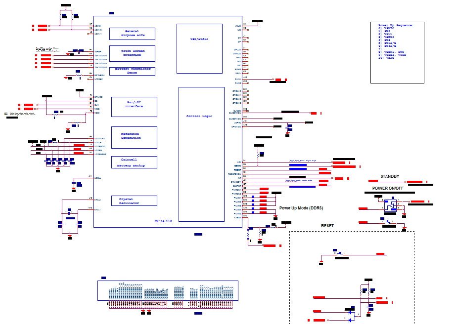

  I have new problem when use MC34708. The schemetic of MC34708 is the same as QSB.
I have only soldered PMIC part on board, and I use wall power(5VDC) as input supply. The problem
is mc34708 can't output all regulator voltage. The voltage I have measured is followed.
内嵌图片 1
I am confused that it's like OFF mode, but VSRTC has cross the Maxim value.
This mc34708 has been damaged?( Once I have measured VSRTC is 1.2V)
And how can I make it at ON mode?

Hello,Cao,
     Let me summarize how to resolve the issue you met on mc34708:
(1)WDI pin should be pulled up to High(1.8V) in 128ms after VCC_BP powers up.
(2)Ext_5V is from external 5V power, it is from USB_OTG_VBUS, so you should connect USB OTG to PC USB,this power will be OK, but 3V3_VUSB is from internal USB regulator, The source of this regulator is Ext_5v when mc34708 starts up, when software runs, this source will be changed to 5V_MAIN, So this 3V3_VUBS can be held.

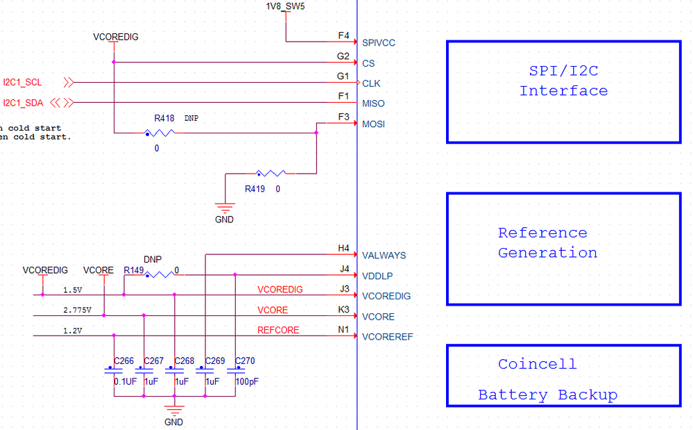

caohaifeng
Hello Weidong,
VCC_BP
3.8V
3.78V
VALWAYS
3.78V
VDDLP
1.5V(ON mode)/1.2V(OFF mode)
1.19V
VCOREDIG
1.5V(ON)/1.2V(OFF)
1.19V
VCORE
2.775V(ON mode)/0V(OFF mode)
0V
VCOREREF
1.2V
1.19V
but VSRTC is 1.35V, sometimes it will be 1.4V. It have exceed maxim value.
By the way ,the crystal works.
The others swicth and regulator have not output voltage. It's strange that
the SW2PWGD have output above 2.4V,but then
it will drop to 0 soon .

weidong_sun
Hello,Cao,
      Your issue can be located at WDI pin on MC34708, this pin should be pulled up to 1.8V via 4.7K resistor.
<note: VDDIO on mc34708 is 1.8V, but NVCC_GPIO is 3.3V, you can connect WDT_OUTPU to WDI pin directly>
The following is correct usage on this pin:
When mc34708 normally works, WDI pin should be High levle(1.8V), if WDI is Low, mc34708 can't normally work !
Weidong

Hello,Weidong,
I check the datasheet of mc34708,rev10.0, WDI can be connected to
WDT_OUTPU .

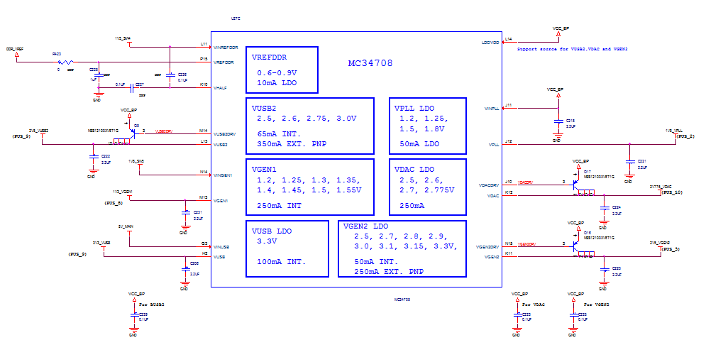

weidong_sun
Hello,cao,
      WDI pin's rating is 3.6V, so 3.3V is used here, this pin can't be damaged. But the digital IO voltages on mc34708 all refer to SPI_VCC, here  we used 1V8_SW5, so VDDIO on mc34708 should be 1.8V.
      WDI Pin should be Pulled up to high in 128ms after VCC_BP(3.8V) power up. Normally, VCC_BP is powered up, mc34708 will output DCDCs and LDOs at once. you don't need to press button connceted at PWRON1 pin.
      I paste a schematic of mc34708 that I have validated here. my email address is : [email protected], you can send email to me ! If you are in china, please tell me you Phone number in email.
Weidong

caohaifeng
Hello, Weidong,
The mc34708 works now according to your suggestion to add pull-up resistor.
Now EXT_USB5V and 3V3_VUSB have no voltages output, the others voltages
works well.

weidong_sun
Hello,Cao,
     EXT_USB5V is External 5V Power, it should be from OTG_VBUS , if you connect USB_OTG connector to USB HOST of your PC, 3V3_VUSB will output .
weidong

caohaifeng
Hello,Weidong,
So the 34708 works well now ,right?
16,082 Views

caohaifeng
re-pasted the first schemetic.
16,081 Views
weidong_sun
Hello,Cao,
      No problems were found from your schematic, Could you tell me which voltages are correct , and which ones are not correct ?
Weidong
