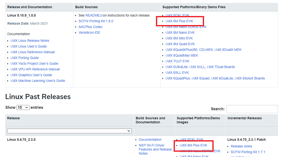

The i.MX8MP binary release contains the uuu script.
The default is to write to the emmc boot0 not the user partition.
BTW, all the i.MX. It is all. the uuu script default is to write to the emmc boot0 not user partition.
and boot0 is the index for the Linux. In the emmc spec, it call boot1, boot2 and user partition.
Please download the i.MX8MP, binary release to check.
Embedded Linux for i.MX Applications Processors | NXP Semiconductors
