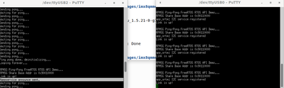

Hello Experts,
I have the imx8qm mek board and I want to test the rpmsg between M4 core 1 and Linux.
One M4 core 0 everything works, but on M4 core 1 it does not.
This line of the code is never executed:
(void)PRINTF("Nameservice announce sent.\r\n");
Does anybody have an idee what can be done?
The rpmsg dtb file was loaded.
Br,

I assume that you use rpmsg_lite_pingpong_rtos example, right? refer to the readme, it seems your print information is correct
"#define RPMSG_LITE_SHMEM_BASE 0x90010000" in main_remote.c for Cortex-M4 core0,
"#define RPMSG_LITE_SHMEM_BASE 0x90110000" for Cortex-M4 core1.
Running the demo
This examples shows how to implement the inter-core communicaton between Cortex-M4 core and Cortex-A core using rpmsg-lite library.
After the boot process succeeds, the ARM Cortex-M4 core0 terminal displays the following information:
RPMSG Ping-Pong FreeRTOS RTOS API Demo...
RPMSG Share Base Addr is 0x90010000
Link is up!
Waiting for ping...
For Cortex-M4 core1 terminal displays the following information:
RPMSG Share Base Addr is 0x90110000
app_srtm: AUTO and I2C service registered
Link is up!
Waiting for ping...
After the Linux RPMsg pingpong module was installed, the ARM Cortex-M4 terminal displays the following information:
Sending pong...
Waiting for ping...
Sending pong...
Waiting for ping...
Sending pong...
Waiting for ping...
Sending pong...
Ping pong done, deinitializing...
Looping forever...

pls check the steps as below, if still failed, pls share your detailed test steps, we already tested these files before release
  1. Use M4 uboot : imx-boot-imx8qmmek-sd.bin-flash_linux_m4
  2. Image: default dtb is imx8qm-mek-rpmsg.dtb
  3. imx8qm_m4_0_TCM_rpmsg_lite_pingpong_rtos_linux_remote_m40.bin  -> rename to m4_0.bin - cp on boot partition
    imx8qm_m4_1_TCM_rpmsg_lite_pingpong_rtos_linux_remote_m41.bin -> rename to  m4_1.bin - cp on boot partition
  4. Open all 4 ttyUSB<x>
  5. Power on the system and stop in Uboot:
  6. Uboot> run m4boot_0
  7. Uboot> run m4boot_1
  8. Uboot>boot
  9. imx8qmmek:~#insmod /lib/modules/5.10.72-lts-5.10.y+g48772d50cdec/kernel/drivers/rpmsg/imx_rpmsg_pingpong.ko
