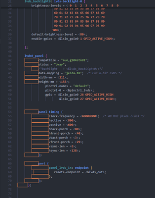

We are using imx8qxp with custom carrier board. We are using a G104STN010 display.
I am able to get display backlight and control it but there is not display output.
we are using custom OS with kernel version :- 6.6.36
dmesg logs show Failed to create device link (0x180) with 56180000.dpu

Below is my device tree configuration:-
lvds0_panel {
            compatible = "auo,g104stn01";
            status = "okay";
            /*backlight   = <&lvds_backlight0>;*/
            data-mapping = "jeida-18";  /* For 6-bit LVDS */
            width-mm = <211>;
            height-mm = <158>;
                pinctrl-names = "default";
                pinctrl-0 = <&pinctrl_lvds>;
                gpio = <&lsio_gpio0 26 GPIO_ACTIVE_HIGH
                        &lsio_gpio0 27 GPIO_ACTIVE_HIGH>;
            panel-timing {
                  clock-frequency = <40000000>;  /* 40 MHz pixel clock */
                  hactive = <800>;
                  vactive = <600>;
                  hback-porch = <88>;
                  hfront-porch = <40>;
                  vback-porch = <3>;
                  vfront-porch = <29>;
                  vsync-len = <6>;
                  hsync-len = <128>;
            port {
                  panel_lvds_in: endpoint {
                     remote-endpoint = <&lvds_out>;
&ldb1_phy {
      status = "okay";
&ldb1 {
      status = "okay";
      lvds-channel@0 {
            fsl,data-mapping = "spwg";
            fsl,data-width = <18>; /* LVDS data input selection 6bits */
            status = "okay";
            port@1 {
                  reg = <1>;
                  lvds_out: endpoint {
                        remote-endpoint = <&panel_lvds_in>;
is my device tree configuration correct? or is there any changes to be done to bring up lvds diaplay.

Zhiming_Liu
The driver can't parse pane-timing from dts.
You may need adjust the code indentation to solve this problem
Zhiming

adnan_dst
As you had suggested i have fixed the indentation issue in device tree i have attached the updated device tree and the dmesg complete log.
After fixing the indentation issue still we are facing the same issue we are able to get backlight but no gui display.
