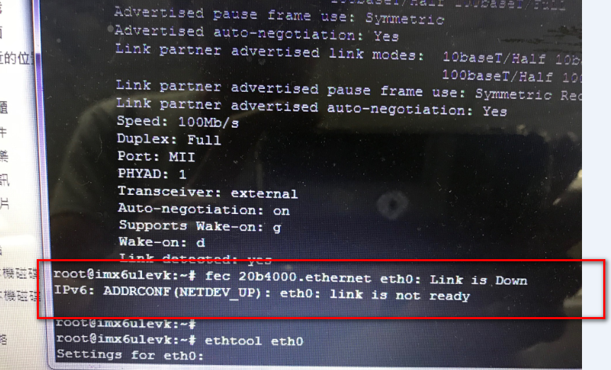

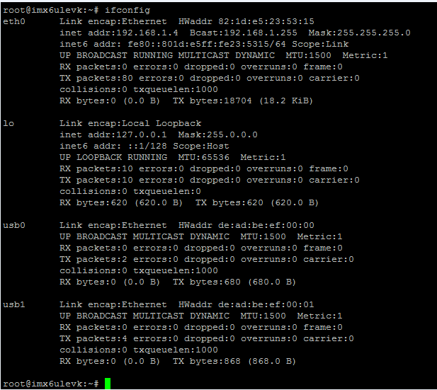

I try to ping DUT in the same domain, but it can not work.
SoC I.MX6
Module RTL8201F
  • I have check eth0, and modify IP addr.
$/etc/init.d/networking stop
$ifconfig eth0 hw ether 82:1d:e5:23:53:15
$/etc/init.d/networking start
$ifconfig eth0 192.168.1.4 up
$ ifconfig
  • I have used ethtool to check. And I  remove Network Cable , the log has show link is not ready .pastedImage_1.png
  • I have check dmesg. It looks okay.

  • The phy_id is show 0x001cc816. It is for RTL8201F.

Hi jason
had you used linux driver for that chip:
net: phy: realtek: add rtl8201f driver - Patchwork
first please try in uboot, seems processor used in that case is i.MX6UL, try nxp uboot:
http://git.freescale.com/git/cgit.cgi/imx/uboot-imx.git/tree/?h=imx_v2016.03_4.1.15_2.0.0_ga
also one can try loopback test.
igor
2,880 Views
jason9tsai
Hello Igor,
   I have modify device-tree, it can work.
   Thanks for you help !!
