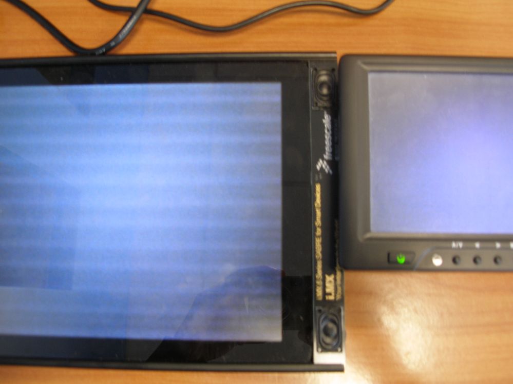

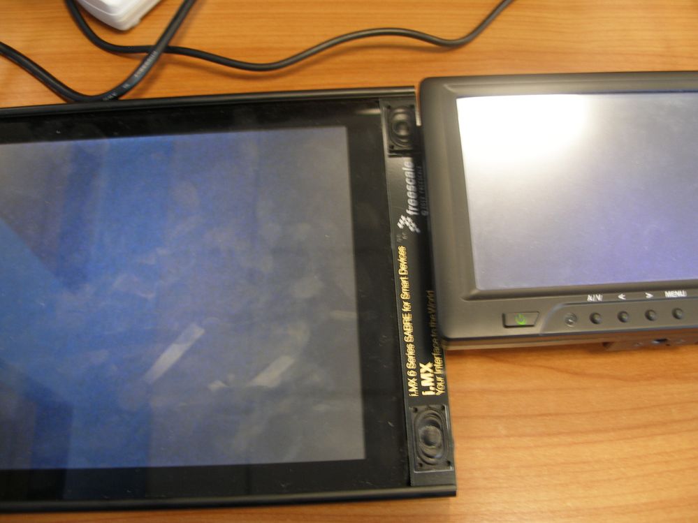

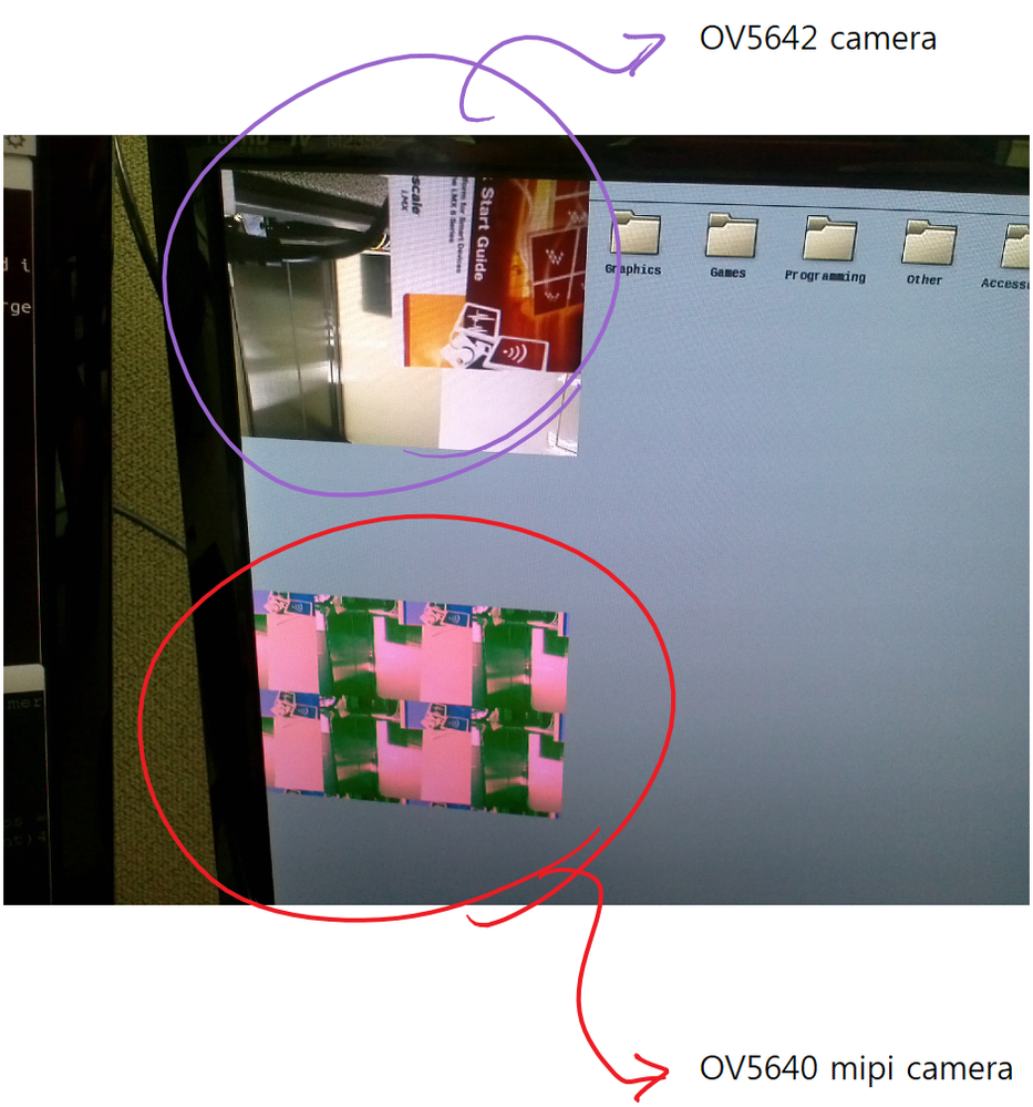

nkkang
Thanks your reply
but you patch has some problem. need your help
1. it is not working for recording  at the same time  and faling into the same situation ...
2. it is working for display at the same time ... but image is not good (mipi camera) ... change color between R and G ... and display is divided ...
thanks
NK
9,130 Views

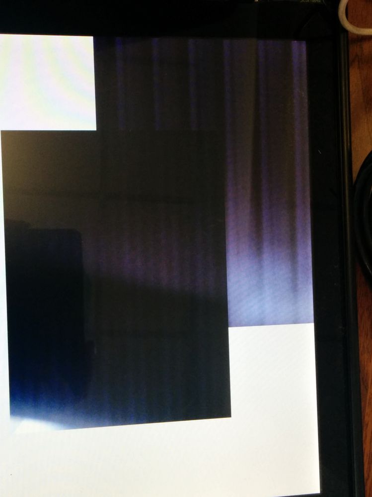

edison_fernande
I'm able to enable both cameras at the same time by using the following patch:
Index: kernel/linux-3.0.35-4.0.0/drivers/media/video/mxc/capture/ipu_csi_enc.c
--- kernel.orig/linux-3.0.35-4.0.0/drivers/media/video/mxc/capture/ipu_csi_enc.c 2013-10-07 14:42:58.927083104 -0600
+++ kernel/linux-3.0.35-4.0.0/drivers/media/video/mxc/capture/ipu_csi_enc.c 2013-10-07 14:44:19.031082649 -0600

but when i'm displaying at 480p i get some interference in both channels:
The output looks better when using a 720p resolution:
I'm using kernel 3.0.35-4.0.0.
BTW: i also tried with the patch suggested by Leonardo with same results as NK Kang.
Any help will be appreciated!!

I finally had the time to give a try to your patch and sadly I'm getting the same results as applying the patch I suggested in previous posts. I basically get some artifacts in the video when I'm capturing from both cameras.
I tested with kernel 3.0.35-4.1.0 and kernel 3.10.17-1.0.0_ga in a Sabre-SDP Qaud Core with the same results. I also tried with gstreamer and with the mxc_v4l2_overlay.out application and both produced the same results:
This is the command I'm using:
./mxc_v4l2_overlay.out -t 200 -ow 640 -oh 480 -di /dev/video0 & ./mxc_v4l2_overlay.out -t 200 -fg -ot 200 -ol 200 -ow 640 -oh 480 -di /dev/video1
Here is a picture of what I'm seeing:
It is not a very good image but at least you can see the artifacts (those horizontal stripes in both videos).
Any help will be appreciated.
Edison
9,130 Views

edison_fernande
Hi Rogerio,
I tried sending one capture to a fakesink and the other to the display with the same results.
If I only capture from one camera at a time the video is fine, the problem only appears when I'm capturing from both cameras at the same time.
Edison
