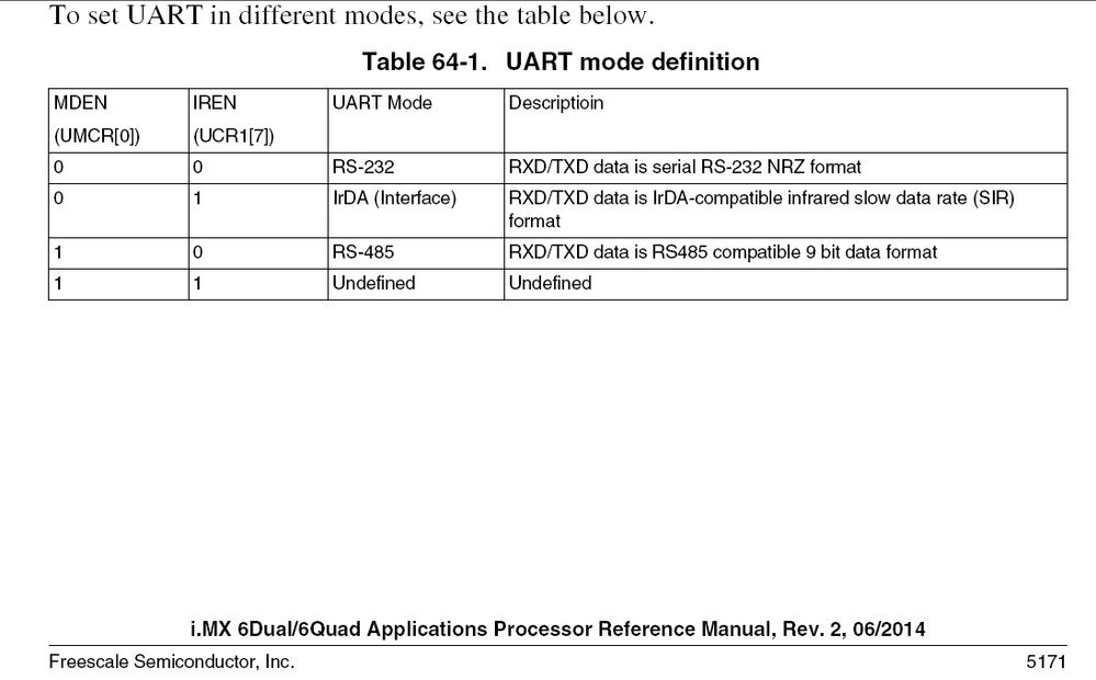

one can add debug printfs to linux..tty/serial/imx.c (it has "#ifdef CONFIG_IRDA ")
and check  MDEN, IREN settings as in attached part of RM
igor

I've already checked of IRDA mode procedure. and MDEN, IREN setting id is below.
Can you check it what I missing it ?
I think that I've do that any method as possible. but I don't get any event.
# ./memtool UART2.UCR1.IREN=0x01
# modprobe irtty-sir
# irattach /dev/ttymxc1 -s
# irdadump -d -x -s 256

igorpadykov
Hi Christian
if MDEN, IREN are set then UART is working in irda mode
SIR format. In this mode you should place irda transceiver
before UART input/output, however from user point of view
operation is similar to conventional UART.
So you should work with it in usual "UART" way.
SIR format provides ability to convert irda signal to such
form, that uart working with it as with usual UART signal (not irda).
~igor
