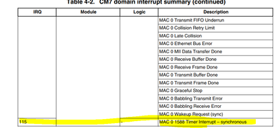

Please explain the highlighted interrupt means when it will happen, what's it's function.
in imxrt1060RM.pdf

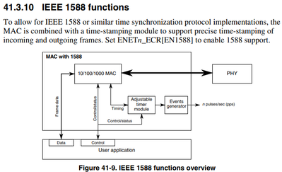

The ENET module includes a MAC with 1588 functionality. As described on section "41.3.10 IEEE 1588 functions":
The interrupt you mention refers to the interrupt that the adjustable timer module is capable of generating for synchronized time-stamping.
