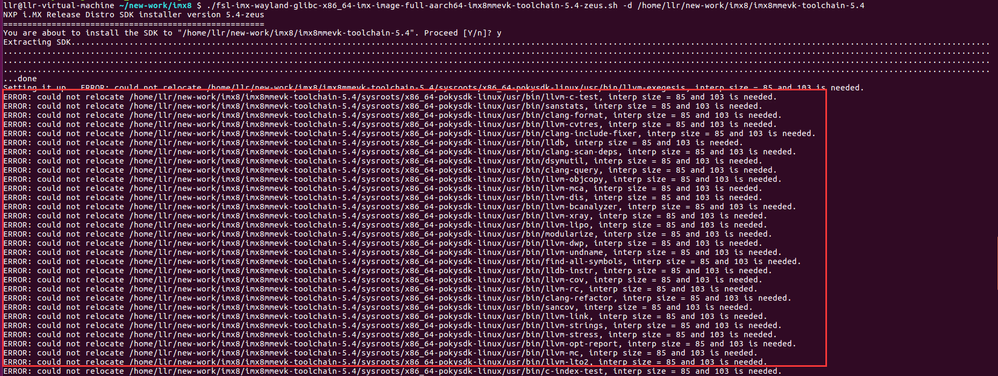

      I successfully compiled the SDK using the following command.
      repo init -u https://source.codeaurora.org/external/imx/imx-manifest -b imx-linux-zeus -m imx-5.4.70-2.3.0.xml
      DISTRO=fsl-imx-wayland MACHINE=imx8mmevk source imx-setup-release.sh -b build-wayland
      bitbake imx-image-full -c populate_sdk
      However, an error occurred when installing the SDK. How should I solve this problem?
      HOST: ubuntu 16.04QQ图片20210223181156.pngQQ图片20210223181156.png

one can follow sect.3 Host Setup i.MX Yocto Project User’s Guide​
"The recommended minimum Ubuntu version is 18.04 or later."

I tried installing the SDK in Ubuntu 18.04 and got the same error.
I built the SDK in Ubuntu 16.04. Do I have to recompile the SDK in Ubuntu 18.04?
