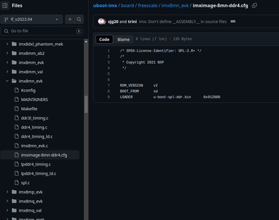

What is the purpose of .cfg files included in multip imx evk board files (ex: imx8mn_evk)? I also see them under mach-imx arch folder. It is not clear how these files are used or if they are used at all. Do we need them or can I just delete it them from the board files? If we need them, can you please explain the syntax and how they are used? We have a boot-up issue, and we are wondering if they are the source of the spl not loading. Thank you.

I searched around but no document talk about it. The cfg file was used for DDR configuration for i.mx5, i.mx6. But now, for the i.MX8M, the DDR configuration is put in the <memory>_timing.c. (e.g. ddr4_timing.c). I think it is no need to use for i.MX8M. What error/issue you met? could you tell me more details?

I am having an optee and secure boot issue but it may not be related to these files. I was just trying to troubleshoot all board files and didn't know the function of these .cfg files.
So just to be clear, are you saying .cfg files in board directories and the mach-imx directory are useless?

@jimmychan I am familiar with the information you shared, but my question is specific to the .cfg files I pointed out. None of the resources you shared discuss these files, so my question is: Are they useless, or are they used in some other way that may not be obvious? Thank you.

As for my current understanding these configuration files are being used to generate spl.bin which is fed to binman in the next build stage. DDR firmware and the second loader became redundant due to Binman. Better yet, I have not found a option to generate u-boot.itb before this step is triggered.

I think you could try to remove it. I think it is not an important config file for the code building.
