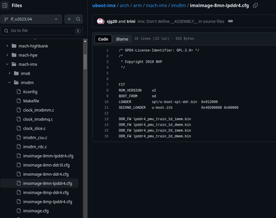

What is the purpose of .cfg files included in multip imx evk board files (ex: imx8mn_evk)? I also see them under mach-imx arch folder. It is not clear how these files are used or if they are used at all. Do we need them or can I just delete it them from the board files? If we need them, can you please explain the syntax and how they are used? We have a boot-up issue, and we are wondering if they are the source of the spl not loading. Thank you.

I searched around but no document talk about it. The cfg file was used for DDR configuration for i.mx5, i.mx6. But now, for the i.MX8M, the DDR configuration is put in the <memory>_timing.c. (e.g. ddr4_timing.c). I think it is no need to use for i.MX8M. What error/issue you met? could you tell me more details?

As for my current understanding these configuration files are being used to generate spl.bin which is fed to binman in the next build stage. DDR firmware and the second loader became redundant due to Binman. Better yet, I have not found a option to generate u-boot.itb before this step is triggered.
