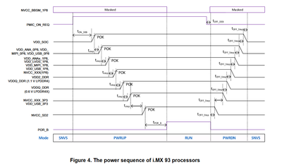

Chavira
Hi @LJGardasoft!
The power seaquence should be like this:
IF you confirm that is correct you have to confirm the next recommendations for the 24 MHz crystal:

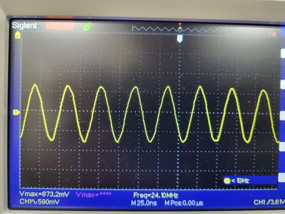

Chavira
Hi  @LJGardasoft!
its difficult for us to help you in custom designs and always recommend to refer to our evks in that cases.
For this case you can refer to imx93 qsb because you are using the 9x9 package and the qsb is using the same package.
You can provide a external clock signal to do the test.
Can you send me your schematic to validate by my side??
I put my iMX93QSB in download mode and I get the next signal:
Best Regards!
