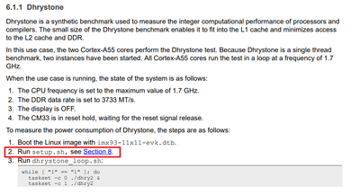

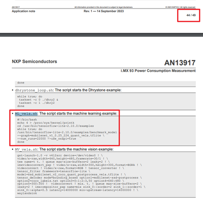

Hello community
According to AN13917 , some of test requirement will need some files. But not know where and how to get those files.
  • Stress test use cases
    • mobilenet_v1_0.25_224_quant_vela.tflite
    • ethosu_apps_rpmsg_coremark.out
  • Linux Suspend + CM33 CoreMark (TCM)
    • power_mode_switch_coremark.bin
  • Core benchmark use cases
    • ./dhry2
    • ./coremark
EVK could run dhry, but not sure the parameters is correct or not.

Zhiming_Liu
1.For dhry2 and coremark
2.ML and vela
For other firmware:https://www.nxp.com/docs/en/application-note-software/AN13917SW.zip
1 返信
