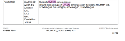

According to iMX Linux Release Notes, i.MX 93 and i.MX 91 do not support OV5640 camera sensor. They support MT9M114 with 320x240@25, 640x480@25, 800x480@25, 1280x720@25.
Best Regards!
Chavira

我在6.1.3版本中修改设备树之后是可以是使用OV5640的,根据你的反馈,在6.12版本中是不能使用该模块吗?

Since the first BSP compatible with the iMX93 (6.1.1) the Note is the same.
