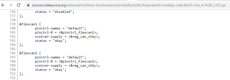

As described in the <i.MX linux Release Notes> Rev.L4.14.78-1.0.0_GA, 01/2019 Charter 2.1 the kernel supports CAN-FD. Then  I downloaded the image based on L4.14.78 and flash the *.sdcard file into the SD card.
when the MEK board boots,it show the kernel version 4.14.78 and it is confirmed that the L4.14.78 image has been flashed successfully.
however, when I check the "ifconfig" there is no can0 or other can bus information.
so i try to recompile the kernel using "bitbake imx-linux -c menuconfig",and see all of the options regarding CAN bus are already included, and I did not recomliled the kernel again, only to see the CAN options.
In my mind, IMX8 has its own CANFD ,so there is no need to connect a extended CAN chip using SPI, or a BB borad, and the CAN drivers can be found directly in the kernel, but it doesn't.
in a word, how can i deploy the CAN/CANFD function in my design?

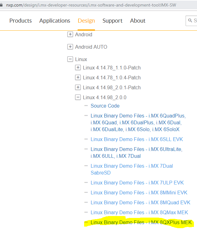

Hello, vincent.aubineau
I just performed what you are asking me.  unfortunately it is the same as before.
is there a missing setting for H/W board?
To check the date out I execute the command "cat /proc/version" at the end of the message.
after seeing the date I am sure writing is ok.
This is the messages what I get after flushing into sd card.

notify1forme
Hi, vincent.aubineau
Thank you for your helping me out
I solve the problem for CAN not detected.
Actually I download command named 'uuu uuu.auto' that makes me happy for CAN which is working well
Question 1.
Why do I get to fail to get the same condition without modification? 4.14.98_2.0.0_ga
=> I Just follow the rules written in documentation in yocto release.

notify1forme
Hi, vincent.aubineau.
I've changed dtb file as you suggested "fsl-imx8qxp-mek.dtb" but I got messages continuously.
and I don't see a cursor at the end of booting. there are messages  circulated like it below
 [ 3.476049] imx-drm display-subsystem: master bind failed: -517
[ 3.504521] [drm] Supports vblank timestamp caching Rev 2 (21.10.2013).
[ 3.511173] [drm] No driver support for vblank timestamp query.
[ 3.517218] imx-drm display-subsystem: bound imx-drm-dpu-bliteng.2 (ops dpu_bliteng_ops)
[ 3.525456] imx-drm display-subsystem: bound imx-dpu-crtc.0 (ops dpu_crtc_ops)
[ 3.532797] imx-drm display-subsystem: bound imx-dpu-crtc.1 (ops dpu_crtc_ops)
[ 3.540174] imx-drm display-subsystem: failed to bind ldb@562210e0 (ops imx_ldb_ops): -517
[ 3.548614] imx-drm display-subsystem: master bind failed: -517
I always thankful to you for handling it sincerely.

Aubineau_FAE
But what have you compiled exactly? To what I see your are booting a virtualized Linux. So the CAN FD is certainly in the Cortex-M4 partition.
So let restart from scratch.
standard pre-generated images
Can you please try our standard image:
i.MX Software | NXP
Download the image for the i.MX8X MEK board:
Then load it in the eMMC with a USB cable and UUU (Releases · NXPmicro/mfgtools · GitHub ), under Linux should be:
sudo ./uuu uuu.auto
Boot the board to see if it works.
Your generated image
Now you know our standard images works, rebuild your image:
bitbake -k fsl-image-validation-imx‍
in tmp/deploy/images/<your image name> use uuu once again to load it on your board thru USB.
If you want to load it in eMMC:
sudo ./uuu -b emmc_all imx-boot-imx8qxpmek-sd.bin-flash fsl-image-validation-imx-imx8qxpmek.sdcard.bz2/*
if you want to load it on a SD card:
sudo ./uuu -b sd_all imx-boot-imx8qxpmek-sd.bin-flash fsl-image-validation-imx-imx8qxpmek.sdcard.bz2/*
Test it and it should work like a charm.
Vincent

Your DTB certainly does not contain FlexCAN, consequently you cannot see it.

Please in u-boot shell, try to change your device tree file:
setenv fdt_file 'fsl-imx8qxp-mek.dtb'
saveenv
