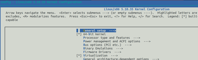

3  the follow steps had been tried to change/modify kernel .
3.1 $cd ~/android_build/vendor/nxp-opensource/kernel_imx
3.2 $make menuconfig
3.3 $make -j8

3.4 The result was the kernel Image hadn't been generated .
summary: How to work with kernel as standalone build environment under Android 11?

You can try these two ways:
1.add CONFIG_XX to imx8_defconfig manually
2.make ARCH=arm64 imx8_defconfig , and then make menuconfig,after you change the config, you need save .config to imx8_defconfig:make savedefconfig && mv defconfig arch/arm64/configs/xxx_defconfig
