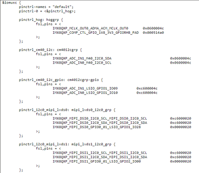

Hi @petero5
The device tree must be configured in the Linux Device Tree file (.dts and .dtsi).
Here you will need to change the mux_mode bits in the proper register.
About the relation of dts files with the Reference Manual, sometimes there is no relation with the default values in the Reference Manual. But it is important to correctly follow the diagram and fields detailed in the same document.
I will attach a link to the Code Aurora which is a repository for Device Tree files based on NXP EVKs.
Link: freescale\dts\boot\arm64\arch - linux-imx - i.MX Linux kernel (codeaurora.org)
For example, this is a part of device tree for iMX8QXP.
In pinctrl_i2c0_mipi_lvds0: mipi_lvds0_i2c0_grp > "IMX8QXP_MIPI_DSI1_I2C0_SCL_MIPI_DSI1_I2C0_SCL" with a value of 0xc6000020. You will need to find this register in the IOMUX memory map and then apply the changes in this file.
Finally, unfortunately, there are no documents or training for this topic.

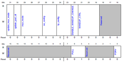

For example in IMX8DQXPRM.pdf
i.MX 8DualX/8DualXPlus/8QuadXPlus Applications Processor Reference Manual, Rev. 0, 05/2020
9.2.5.1.104.2 Function
pad/mux control for SPI0_CS1
31 update_mux_mode update lock for mux control
write 1 to allow programming to mux control [29:19]
30 update_pad_ctl update lock for pad control
write 1 to allow programming to pad control [14-1:0]
29-27 mux_mode
100b - LSIO_GPIO1_IO07
With bits 31=0b, 30=0b and 29-27=100b that would be 0x20...
With bits 31=1b, 30=1b and 29-27=100b that would be 0xE0...

Also, what does this mean:
When do I need to use that?
Do I need to set that bit too in order for 29-27 mux_mode to actually work?
Or does that apply to a different situation?
I searched the doc for update_mux_mode but can't find anything that explains what "allow programming to mux control" actually means?
