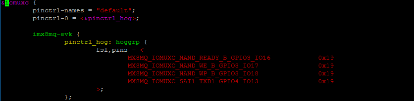

When i operation gpio109(GPIO04_IO13) , I use sysfs and memtool  to succeed and see the results,but when i use code,i don not see results ,follow:(DTS has been modified,This is because we need to adapt to the GPIO Library of raspberryPi)
